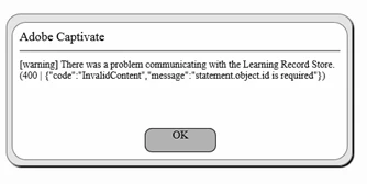

Warning 400 there was a problem communicating with the Learning Record Store

Has anybody seen this error when launching a Captivate 8 course from an LMS.  It doesn't do it on my work pc but it does on my client's.  The full message is this
Our LMS provider suggested that I add a number of email domains to the client's whitelist which they have done, but this hasn't sorted the problem.  It happens on launch only.  If they click OK it will let them proceed but am sure that's not good.

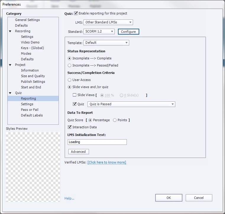

    I would suggest you confirm your SCORM/AICC versions against the documentation for the LMS.
    Click configure to see:
    You can see, I've specified SCORM 1.2, but you might be using SCORM 2004, or even AICC.
