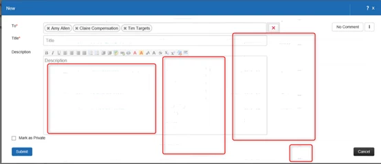

Watermarks/Blurred Lines on SCORM published file.
When I publish my captivate file there is no problem, however when i then upload it to my LMS system there are watermarks or faded lines etc on some of the slide.
I have uploaded a few files with issue to separate LMS systems and the issue still recurs. I have tried adding in extra slides or taking away slides to eliminate the problem as well, however this has not worked. It seems to be an issue that occurs when in SCORM format and uploaded to any LMS system.
It is most definitely an issue derived from captivate.
There are no copy and pastes on any of the slides where this is being shown.
Could someone please hep me with this

Aug 20, 2019 8:27 AM UTC
Hi all - thank you for your reply's.
I have attached an image showing the issue now.
I am publishing to HTML5
I am creating a software simulation
The version number is 11.0.1.266
I have tried publishing to SCORM 2014 and SCORM 1.2

Aug 20, 2019 8:29 AM UTC
I have attached this info Now - thank you

Aug 20, 2019 9:00 AM UTC
I have now attached this information - Thank you
Lilybiri
Aug 20, 2019 9:04 AM UTC
Even a software sim can be in a responsive project, I presume that is not the case?
Did you rescale the project? It looks like you used a very big capture window, what was its size in px?
