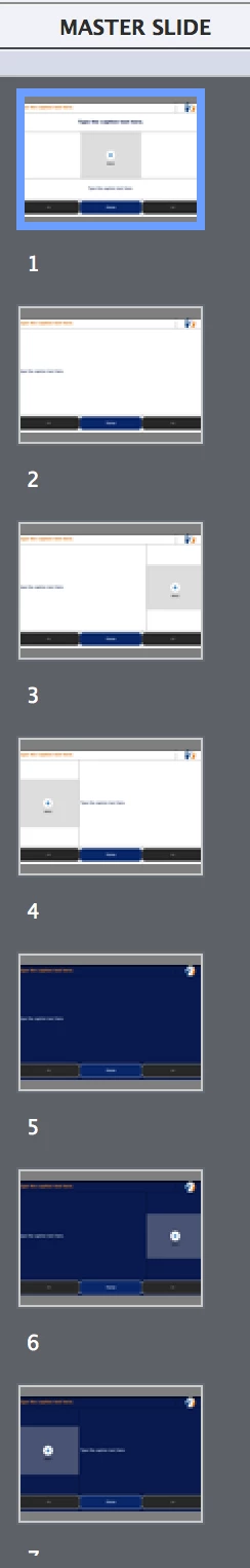

So I have a cptx file that I have created. I have created multiple Master Slides, as can be seen here:

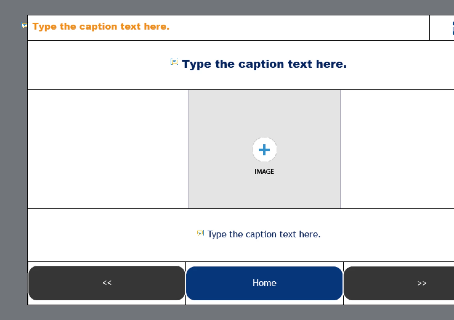

I have several Master Slides for my course:
I need to create 100 courses.
My Questions is: What if I noticed I made a change to a link in a Master Slide - as an example. Would I then have to go in to every course, open up the Master Slide View and then replace all of the buttons in every one of my Master Slides?

Sorry.. Are you new to Captivate? Do you know the importance of a Theme? Did you first set up the Theme Colors palette? Did you create the object styles before editing the Master slides? I see that you want to create Fluid Boxes courses (do you need those really, they have a lot of limitations), did you set up the fluid boxes on the Master slides? It may be the explanation, but to me it looks like you are jumping into a very big project without a good preparation of what is common to all the courses.
What do you mean by a 'Link'? The shape buttons on master slides are part of the theme. Their object style, including the InBuilt States are also part of the theme. But for the 'action' they perform that is another problem. Even if you use shared actions, which I would recommend since they can be in external libraries, you will still have to check each course. I can just offer tips of workflows based on my long experience with Captivate to make the process as smooth as possible. Hope you understand that.
Do not forget that each theme needs at least all the quizzing master slides (5).
