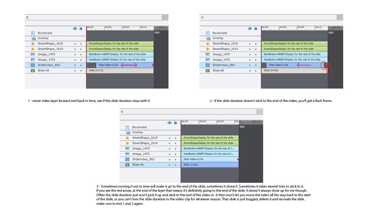

Hey folks - I wanted to write a note here and let everyone know this previous answer that is flagged as correct is not necessarily the answer. I ran into this flash-frame with video problem the last couple of weeks and spent a few hours with adobe support last night getting it worked out, and I have found an actual work around to fix these flash frames.
The cause is Captivate adding an extra millisecond of time on the video which is so short it does not show up in the timeline or anywhere else, you only see it when you preview/publish. Essentially, your timeline shows the video is covering the whole slide, but it's actually a millisecond short of the slide time. It most commonly seems to happen if you've used the 'update' feature to reload your video after making a change or updating compression, etc.
The work around is to go to each slide that has video and push the video out and back in on the timeline, so that it extends/shortens the length of the slide. If the slide duration does not stick to the end of your video you're going to get a flash frame. You can trim up the extra time after you slide your video back to the beginning of the frame, however sometimes the slide is just bugged and you can't trim the last little bit. I've found that the quickest way to resolve it is delete the trouble slide and create a new one or duplicate from a working slide, then place the correct video again, move it around on the timeline and make sure that the slide duration sticks with the end of the video.
One of many silly Captivate bugs but at least it looks like there's something you can do to get rid of it if it starts happening to you.

Jan 13, 2019 4:53 PM UTC
I'm on the latest update of 2019. Here are some screen shots showing what I mean in the timeline. I'm just using regular video slides, created by importing the video or dragging it onto a slide in the filmstrip view.

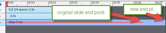

I believe that Captivate is putting the white flashes at the beginning of each movie slide somehow. I have extended the the timeline of the slides to 3/4 of a second beyond the recorded movie to see if that would make it go away.  No change, it still flashes between movie slides.
