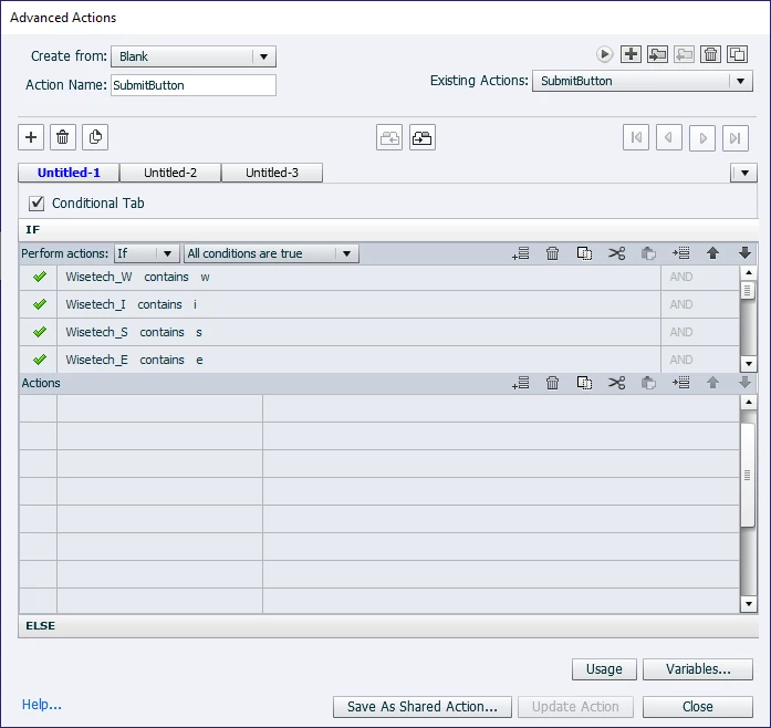

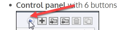

Please pos a screenshot of the Preview window for the used advanced action. That would be more relevant than a very long textual explanation. You find the Preview by clicking the first button in the top right ontrol button of the Advanced Actions dialog box.
Mar 9, 2022 11:11 PM UTC
Thanks, here is a screenshot of the Advanced Action, however last night i did some more testing and found that if I set the varibale to a lowercase, then it worked perfectly!
Im unsure why, but I am thinking what Rod replied with may be the answer. Possibly the 'convert to uppercase' function doesn't work the way i think it should - which may be why when i tested it between upper and lowercase it worked fine to begin with (I would have been using the Shift + key to convert to a capital.)
