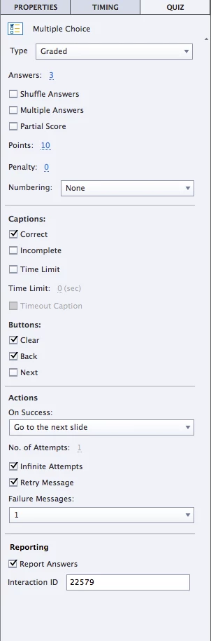

    My settings for quiz are currently:

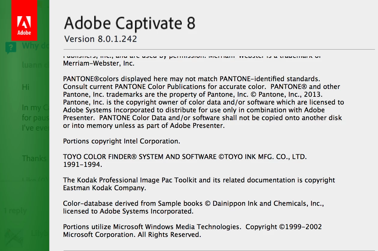

    Oh and maybe I need an update on my version of captivate

    Where are the slides to which you cannot jump? Are they perhaps after or before quiz slides? If yes, can you show the settings for the Quiz? How did you check: if it is not possible to do this after publishing, try F12 (Browser for SWF output) ot F11 (for HTML output) if this is a normal project. Do not use Preview from this slide, or Next 5 slides, because the slides before (and after 5 slides) are not created in the temporary output.

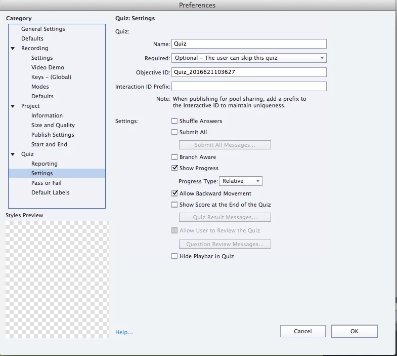

    Quiz Settings are as follows

    You don't use the latest version (8.0.3.???) Sorry I don't remember the exact number, am on 9 myself.

    Sorry, should have been clearer about Quiz settings, you are showing the Question slide properties. : I meant the Quiz Preferences; Settings, especially the option you have chosen for Required? If you changed that option, can you first change it back to Optional to see if the jump buttons are functional in that case?
