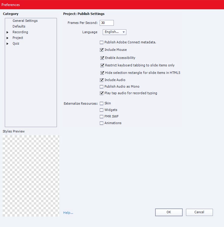

I am using Captivate 2019. I am creating a course. I added knowledge check slides. On the knowledge check slides I have created "help" buttons. When the help button is clicked it takes the learner to the next slide where they can review the answer. On the review slide is a button that returns them to the previous slide, the knowledge check question. If they answer the question correctly, I have the slide set to skip the review slide and advance to the next knowledge check question.
 None of my slides auto advance when I preview it in html and I want them to auto advance except on the ones with the buttons. I suspect the Knowledge check questions are creating the problem, but even if I delete them the problem still exists.
I have checked all my settings. Nothing is different than my other courses. I can't figure out why this is happening.
This is non-responsive course.

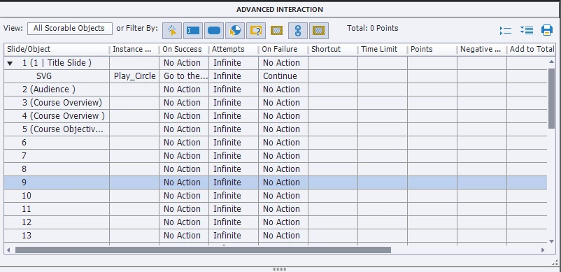

You seem to make it much more complicated than necessary. The screenshots do ont help at all. The Timeline is only a very small part of the complete timeline, you talk about Advanced Actions in the tags, but you show only a small part of the Advanced Interaction panel which has only one Jump to Slide action on a SVG used as button. Quiz Preferences are valid for Knowledge Check slides but not all the Preferences.
