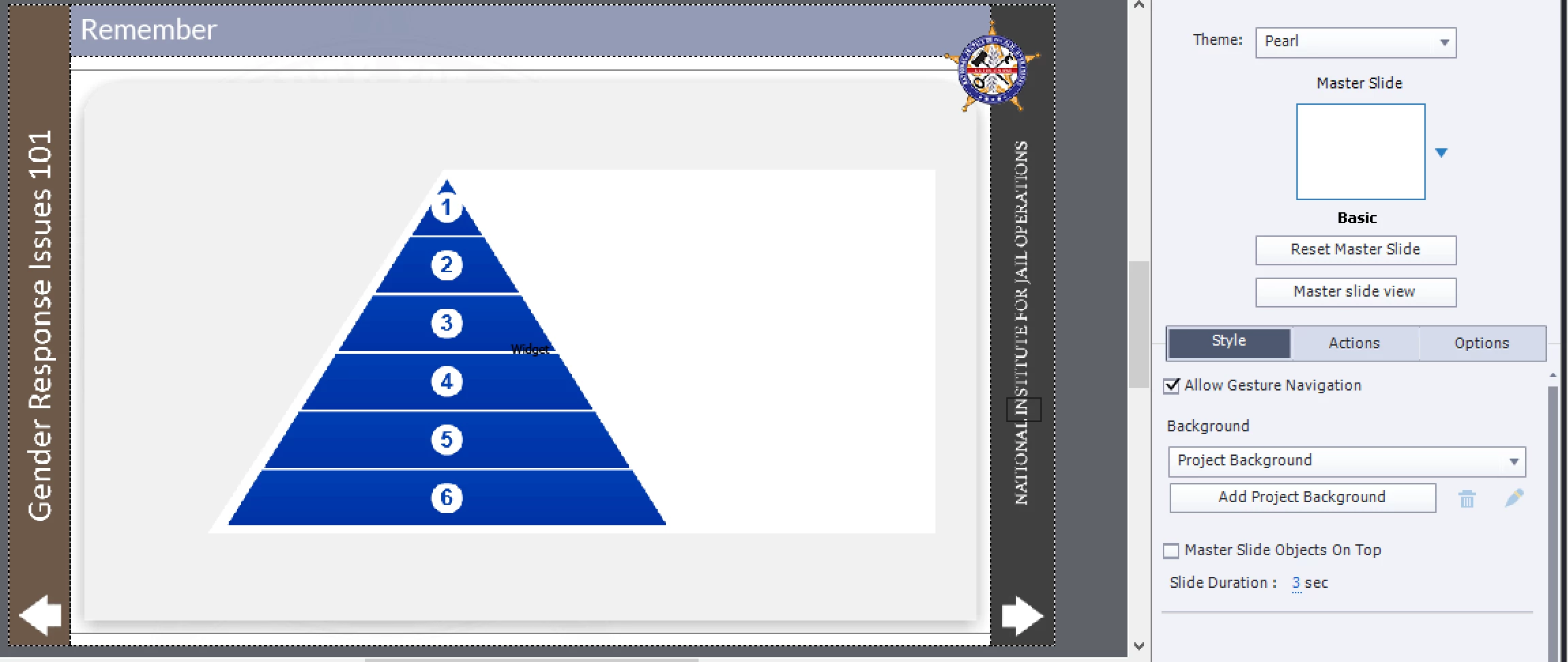

I have  strange question. I have a widget that is attached to a fluid box but when I preview it, it goes out of the slide view...
Here is in progress:

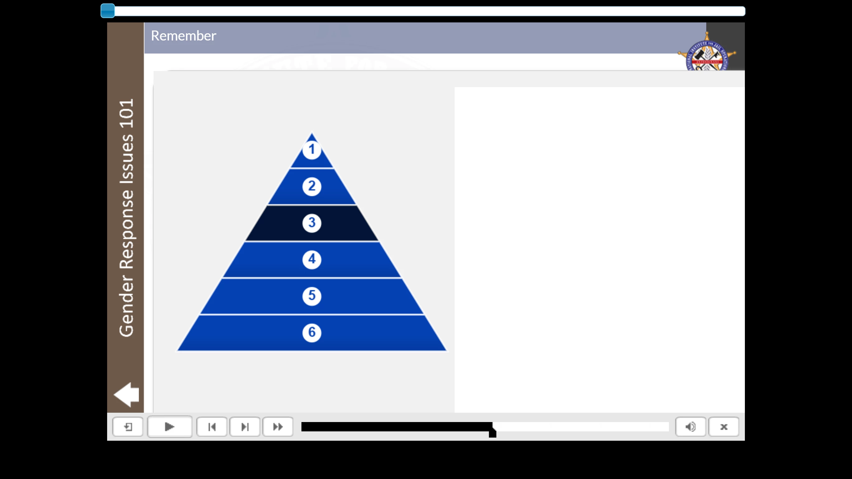

And here it is in preview:
It completely covers up the left bar and next button.

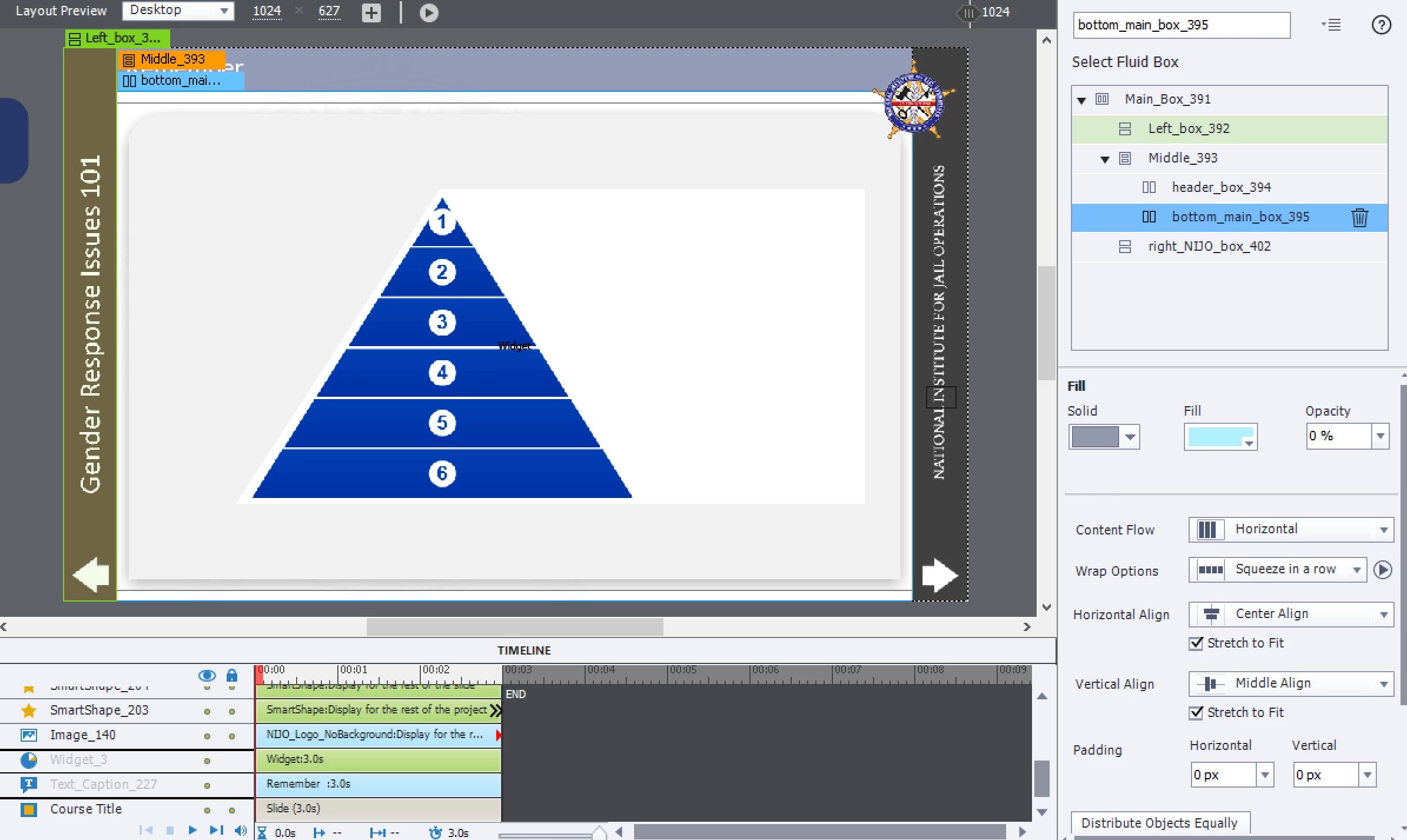

You need to show the Fluid Boxes setup.

Sorry for the late reply, Things got a little crazy around here.
Is this what you are needing?

In the Timeline I see several objects which are not in a fluid box.
The interaction is set in a fluid box with Stretch activated both vertically and horizontally. I would not do that, because the interaction needs to keep its width/height ratio.
