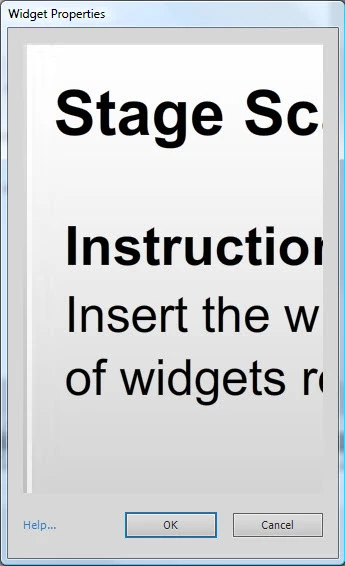

Thank you very much Xeon and CPGuru. The new widget was just in time for me. Quick question: the instruction page that pops up when the widget is inserted is showing very LARGE text. It's to the point that I can only read the first word of every line. As a result I'm not sure if I'm supposed to do anything other than just insert on a random slide within the project that has other widgets.
Could someone provide some more information on this?
Thanks again!
