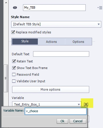

    I suppose you are talking about a Text Entry Box. Each TEV has an
    associated variable, generic name (which I do mostly replace by a more
    significant name, using the X bilutton next to the variable name) is the
    same as the name of the TEB. You can insert that variable .anywhere in a
    text container - can be a caption or a shape -.using a similar X button in
    the Properties panel of the text container. Where to find that button
    depends on your CP version. Which do you use?

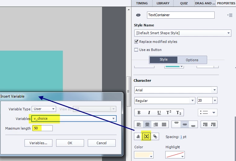

    This screenshot shows the properties panel, Style tab for the TEB. I relabeled it to My_TEB, used the X button  to create a user variable v_choice that will replace the generic Text_Entry_Box_1/
    This is the properties panel of a Shape, I went in Edit mode (double clicking)to make the Character section appear, where you find the X button. It opens the dialog box 'Insert Variable' and you can choose the var associated with the TEB. The Maximum Length will define how many characters will be displayed, the value of a variable has maximum 256 characters.
