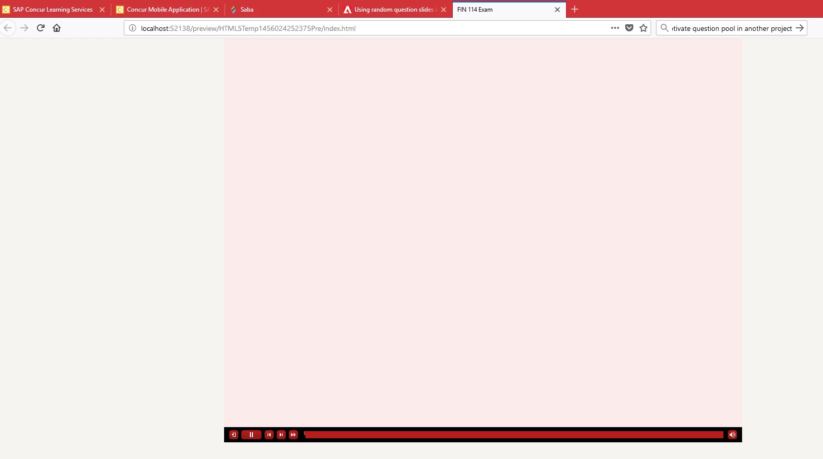

I'm having a similar issue however it won't even show as a preview in the HTML5 browser. I have converted projects from 2017 to 2019 and that seemed to work OK. Then, when you try to publish (SCORM and Non-SCORM) to HTML5 you get a blank screen with the player bar at the bottom. I worked with Adobe and we could get some to work and some that took some effort but I am finding this should be as seamless as it is in Captivate 2017. If you publish in swf it works fine but we don't want to use that, so, my guess is there's a problem.
