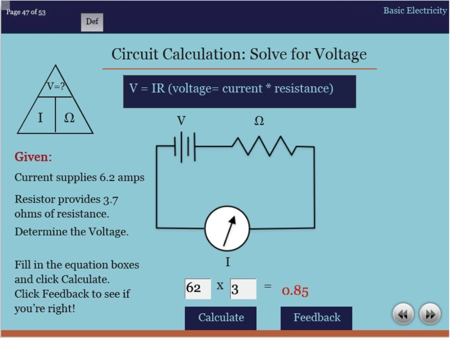

I've created an interaction with text entry boxes.
The user has to type in the boxes and reveal a solution to an equation.
I want them to be able to clear their entry either while still on the slide or I want the entry to reset to blank when they leave the slide.
Is there a way to do this?
Thanks!
Patricia

    What I wound up doing was creating variables and using a conditional action expression to make the calculation.
    I then hid the text entry box submit buttons; added a button to use for  my calculation and assigned the action to advanced actions.
    The only thing I could not figure out how to do was use that one calculation button to also show feedback buttons. So I just created another button and used advanced actions to show/hide appropriate feedback if the learner entered incorrect values in the text boxes.
    If you have any other tutorials on creating multiple calculations that would be a great help. I have added a screenshot so you can see what I needed.
    Thanks again!! You are the best.

    Hi Lilybiri,
    I don't understand if 1 is equal to 1.
    In the interaction I created the calculate button takes the values from the txt box entries and solves for the 0.85 (AnswerSfV)
    The feedback interaction then is set so that if box62 = 62 and if box 3 = 3 then show correct txt or show incorrect txt.
    I do not understand what would be 1 to be equal to 1.
    Thanks.
