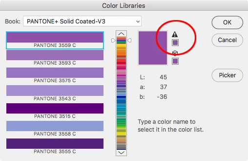

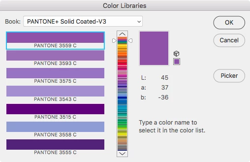

    - Is there any way in Illustrator (or PS I suppose), to easily see which spot colors would be out-of-gamut for CMYK (or MOST out-of-gamut)? This might help us determine which spots to convert.
    Using Photoshop’s Color Picker>Color Libraries is the easiest way to check whether a solid ink is in gamut. If you close all documents the current Color Settings’ CMYK space is used for the gamut. So, a color on the gamut edge might show as in-gamut to a coated profile, but out-of-gamut to an uncoated profile. Here with my Color Settings set to US Web Coated SWOP Pantone 3559C shows as in gamut:
    But if I change the profile to US Web Uncoated SWOP it is out-of-gamut:
    The other way to check gamut is by making the round trip from the measured Pantone Lab value, to the destination CMYK profile, and back to Lab. If there is a significant difference between the starting Pantone Lab values and the converted Lab values, the color is out-of-gamut. For my scripted branding guide I got the gamut info by making the round trip conversion with AppleScript. In the guide there are a fair number of colors listed as out-of-gamut, but are close to the edge.
