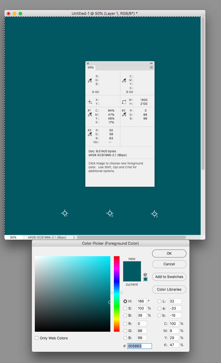

Colour values not matching up
Do anyone know why my colour information doesn't match up with eyedropper info? I created the colour in illustrator cmyk color space, using Pantone color bridge swatch book.
The color is Pantone 3155C c100 m9 y29 k47  is meant to have R0 G98 B114  HEX #006272. I have no idea what I am doing wrong. If you can help, you would truly make my year.

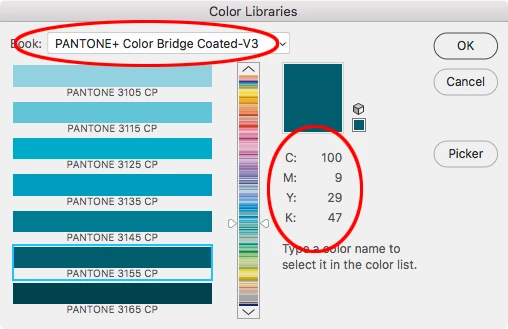

    It looks like you are actually using a Pantone Bridge Library where the colours are listed in CMYK
    Maybe as a first step, you'd be better off with the Pantone Solid library [rather than B ridge] as it's defined as Lab colour rather than CMYK (which I believe is where your confusion springs from)

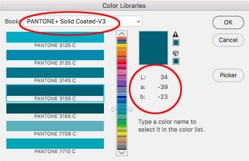

    Here's an example Pantone+ solid coated 3155C and sRGB
    Lab 34 -39 -23 =
    C 100!, M 36!, Y 42!, K 21!** in Coated GRACoL 2006 (ISO 12647-2:2004)
    which = R 0, G 96, B 116 sRGB.icc
    ** the ! mark here means that specific Pantone colour is beyond the capability of Coated GRACoL 2006 (ISO 12647-2:2004) printing, its out of gamut

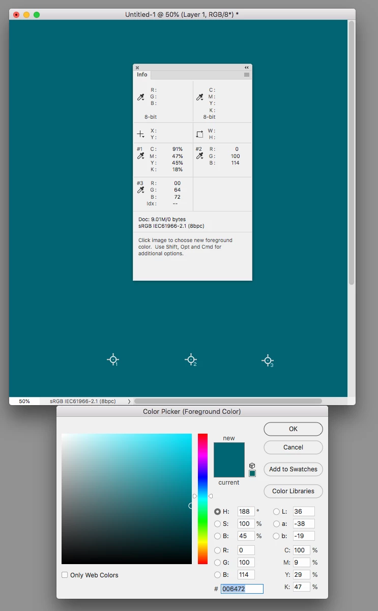

    Also, keep in mind Pantone now provides two different versions of their libraries. As Dov notes the PANTONE + Solid libraries are defined as Lab, but there are also the PANTONE+ Color Bridge libraries, which are defined as process CMYK. I think you are referring to the Bridge library, although the suffix for Coated Bridge colors would be CP.
    Your capture is showing Photoshop’s color picker with the Bridge CMYK definition for 3155, but your document’s color mode is RGB, so the RGB value showing in the Picker is the color managed conversion from your current Color Settings’ Working CMYK Space profile to your document’s assigned RGB profile—sRGB in your case. And, because your document is in RGB mode, the Info panel shows the conversion back to CMYK from your document’s RGB space:
    If I change my CMYK Working Space to US Sheetfed Coated from the default US Web Coated SWOP, and refill with the Bridge color, the RGB appearance of  CMYK 100|9|29|47 changes because of the new profile, and I get a new conversion to RGB:

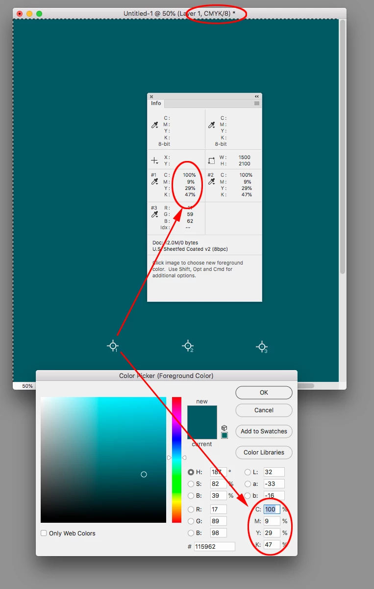

    If I wanted the Info Panel’s CMYK value to match the Pantone Bridge value, the color mode of my document would have to be CMYK:
