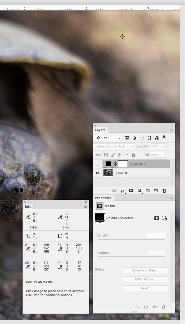

    I want to, for instance, adjust the blue value by 5 units across the whole image.
    If you mean literally move every pixel's blue value by a constant amount there's the Channel Mixer's Output Channel Constant. The amount is a percentage, but here I've added 2% to the blue channel and you can see the 4 samples I've added to this image all have their blue amounts showing as +5

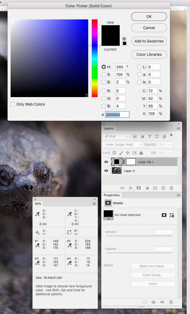

    Another way to do it is with a solid color adjustment layer with its blend mode to Linear Dodge (Add). In this case you can set the adjustment to an RGB value rather than a percentage. Here the color fill is set to 0|0|4, which adds 4 blue levels to all of the pixels. Use Subtract to subtract the amount

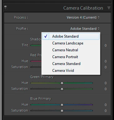

    D Fosse
    Nov 17, 2017 9:43 AM UTC
    stevem38895022  wrote
    I simply want to match the colours from the in-camera JPG algorithm across to the corresponding RAW file without impacting on the quality of the RAW file.
    The camera-matching profiles should at least get you a lot closer. These were in their time added precisely because of requests like this.
    Just note that these profiles are strictly reverse-engineered for visual appearance. They should generally match well, but obviously there will be instances where they miss.
