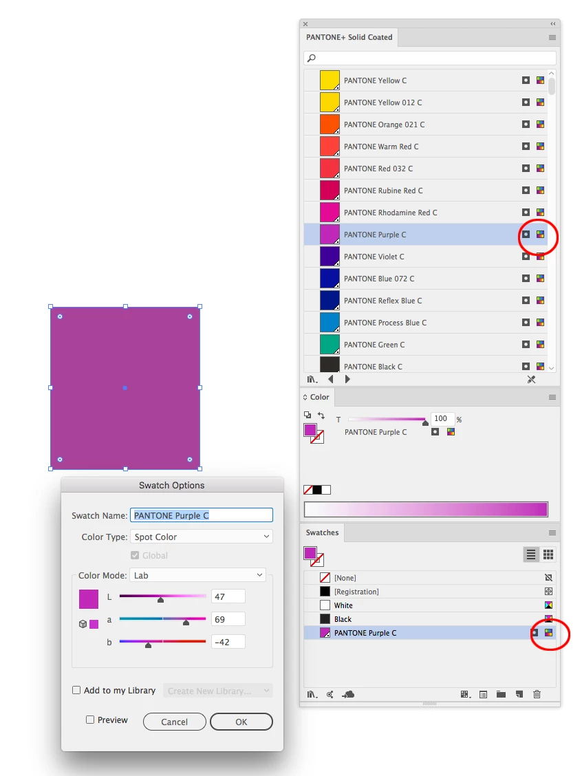

    editing (industry packages) and we are using only solid coated pantones.
    Starting with CS6 there are separate libraries for Pantone's Solid ink colors (the PANTONE+ Solid library) and process CMYK simulations of the solid inks (PANTONE+ Bridge).
    If you are using the PANTONE+ Solid libraries the swatches are defined as device independent Lab values, which have been captured from the printed solid inks with a hardware device like a colorimeter.
    The display of the Lab values is a direct conversion from the Lab color space into your system's RGB monitor profile, so the display accuracy depends more on how accurate the monitor profile is rather than the display itself (although a wide gamut monitor would help with Pantone colors that are out-of-gamut to standard RGB). The accuracy of the monitor profile depends on how the monitor is calibrated. So you should be shopping for a hardware calibrator along with the monitor.
    Here's Illustrator’s PANTONE+ Solid library—the swatch icons are Lab icons.
