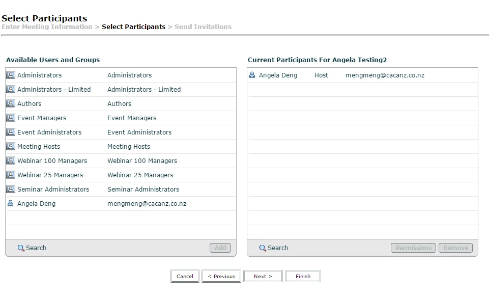

    If you were to go to the Administration Portal and then users and groups. look for your name, click on Information and then Edit Group membership.  Being a trial, you can be in any of the groups but I would suggest Meeting Host, Webinar Host and Virtual Classroom manager, as well as Administrator.  This issue might be because you signed up for a trial with webinar and are trying to run a meeting instead of a webinar.  I can also update the trial to include meeting as well as webinar.
    If the trial is webinar only, try creating a webinar room instead of a meeting room.  They work the same once you open it.

    I registered for a free trial. For Adobe connect meeting, I got one problem When i invite my friends to attend meeting by sending URL, and my friend click on that, it always show" The user limit for this meeting or seminar session has been exceeded. Contact your meeting or seminar organizer for assistance".
    However, in fact, it is only me in this meeting, it can be connected with up to 24 other people.
    When i set up an adobe connect meeting, i met following process, I am not sure is there anything i need to choose.
    When i try to use adobe connect seminar, the problem is not here.
    Could you please give me some advice?
