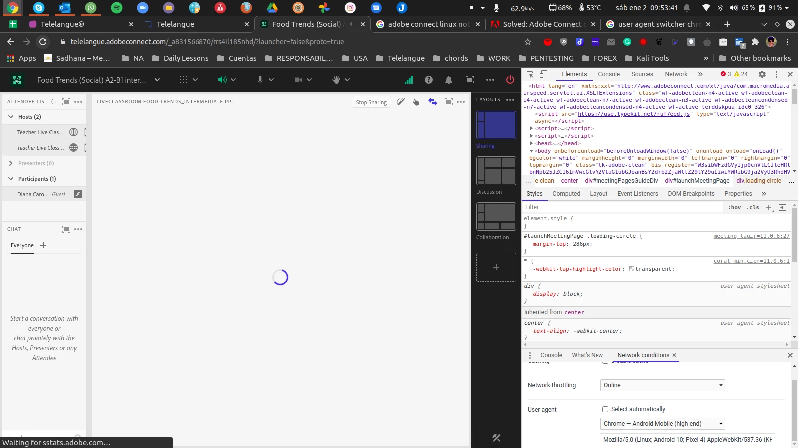

Jan 2, 2021 12:56 PM UTC
Dear All,
The solution I found is awesome!!
Change the user agent by going into developer options>console>network conditions and choose a user agent for a mobile device. For example I chose Chrome Android Mobile High End.
Works like a charm!!! This has been an amazing solution for my job since I was totally waxed and didn't know how to use Adobe Connect on my Ubuntu Linux laptop!!
Heres a screenshot and please write to me if you have any questions so I'll help you out.
Cheers!
FNM

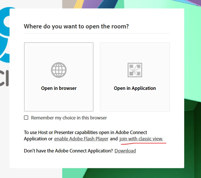

Mar 26, 2020 8:20 PM UTC
It sounds like the group you are taking the class from is having an issue with the part of Connect that delivers the HTML version of Connect. If they resolve that, it will work fine in your browser of choice (other than IE, but don't choose that one).
Because of the small market share of users on Linux computers, the app for that OS was depriciated many years ago. So you won't find one. However, there should be an option when joining before you click on the Open in browser button, where you can select 'join with classic view'. This will have the meeting launch using your browser's Flash Player, so be sure you have that installed before joining.
