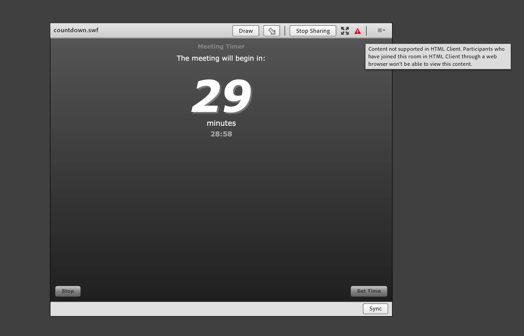

Jorma_at_KnoxCorrect answer
Oct 6, 2017 5:16 AM UTC
  • After you download it from Adobe's website, you should have a SWF file.
  • Upload that SWF file to a Share pod in Adobe Connect.
  • Place that Share pod where ever you would like in your Meeting.
  • Using the pod is just a matter of using the buttons on the interface to set the time and start the timer.
    • Only Hosts and Presenters can set the timer and start or stop it.

Hi guys!
I followed the instruction and it worked! But it kept on showing me the error message that HTML users are not able to see the timer. How can I fix it?
Nov 16, 2020 11:25 PM UTC
I'm having the same issue in regards to Flash vs html5. Any help is appreciated.
Nov 13, 2019 5:23 PM UTC
The link is incorrect. It downloads a clock, not a countdown timer. Can someone check the link?
