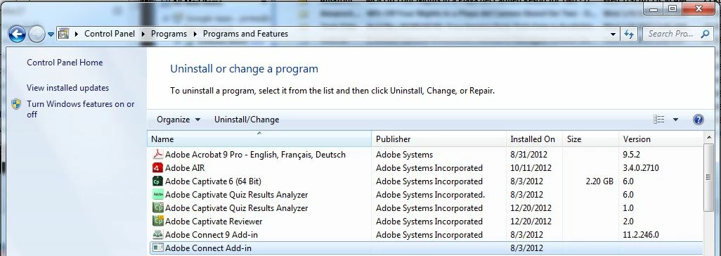

To uninstall the add-in, go to your Start Menu, then Control Panel. Find Add/Remove Programs or Uninstall or change a program. Sort the list by name, and you should see the Adobe Connect Add-In. Select it and then click Uninstall.
I believe there was an issue with Flash Player 11.2 or 11.3 that caused the version notification to show in Connect incorrectly. If the uninstaller doesn't work, then it may need to be solved by Adobe. You can also uninstall Flash Player from the dialog shown above, though the application in the KB article is a more complete uninstaller.
The Connect 8 add-in is backward compatible, though the Connect 9 add-in is not, so be sure you don't have that. As you can see in the screen shot above, I have both add-ins installed.
