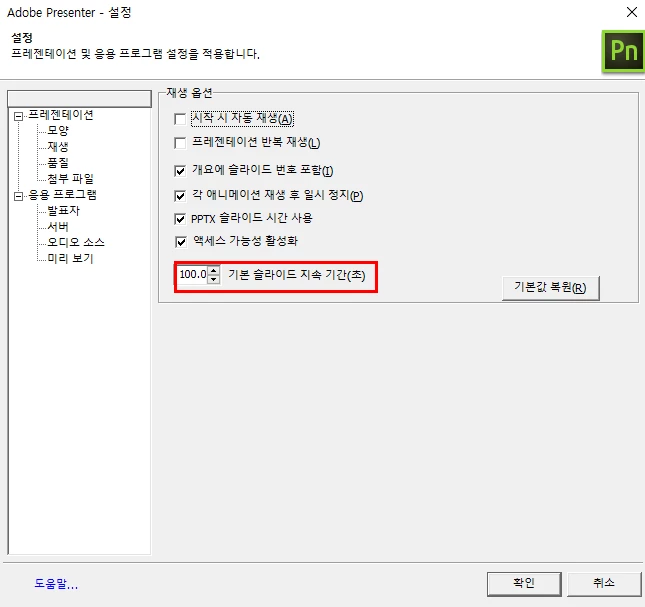

Hi
We are using adobe presenter to match customers LMS service(Adobe connect)
As this contents is used for lecture, we need enough time to explain each slides.
But as you can see below, the max time is 100 seconds for each slide.
So if anyone who use this tools like us, please give us advice.
Thanks
 ■ Setting option
    Jorma_at_Knox
    February 16, 2022
    I believe the max run time for a slide is 100 seconds. The two solutions I'd suggest would be to either:
    • Create duplicate slides if more time is needed. Having 3 of the same slide in a row will give the option for it to display for 300 seconds.
    • Use the option in the live meeting to show the Presentation Playbar. Then you can pause the slide playback while you are lecturing about the content of the slide. You can then click the play button or next button to move on to the next slide when the speaker is ready.
