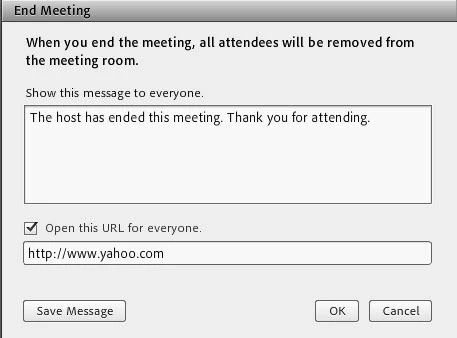

Can I do an exit survey when people leave an Adobe Connect meeting?
I'm looking to do an exit survey on Adobe Connect 9.  I would like to have participants navigate to an page with a survey when they leave the webinar... is this possible?  The only solution I have found so far is to use the "browse to" function in the weblinks and navigate participants there before they leave.

Jorma_at_KnoxCorrect answer
Jul 24, 2013 8:22 PM UTC
You can use the End Meeting function (Meeting > End Meeting). In that tool you can have a custom message display and force everyone to a URL of your choosing.
Breakout rooms are not recorded, only the main room is recorded.

Jorma_at_Knox
