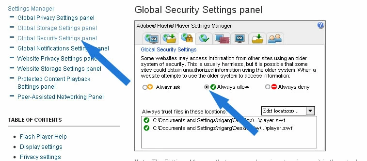

Hi All,
You can fix this issue in Ubantu by going to global setting page mentioned below:
http://www.macromedia.com/support/documentation/en/flashplayer/help/settings_manager04.html
and then by selecting always allow radio button.
