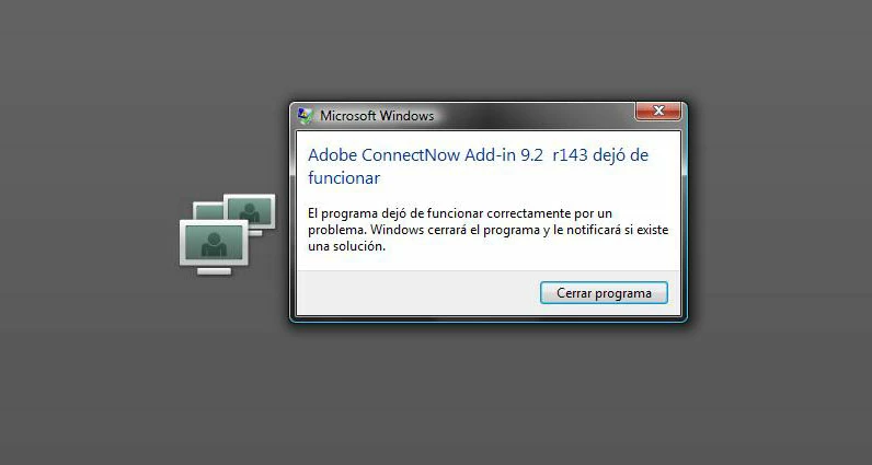

    Jun 10, 2009 11:48 AM UTC
    Hello, I have this error too.
    My configuration System is:
    Windows Vista, Mozilla.
    thanks
