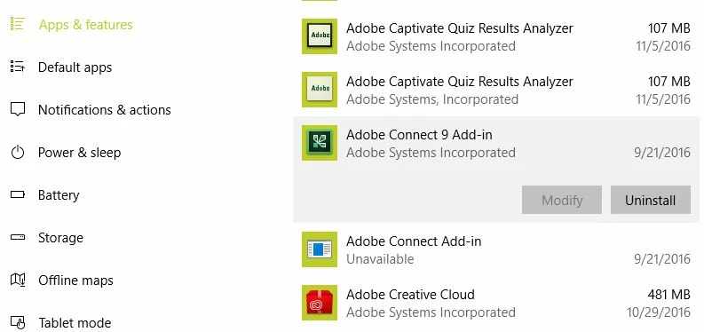

Dec 23, 2016 12:42 PM UTC
The add-in doesn't appear in the list of programs for some reason.
Jorma_at_Knox
Dec 23, 2016 4:01 PM UTC
It should show up as the Adobe Connect 9 Add-in, if it is there.
If you don't see it, then you should re-install it. You can either use the web site referenced above or you can add ?lightning=true to your meeting URL to install it.
Have you tried using the ?launcher=false parameter with the room URL to see if it works?
Can you provide a screen shot of the loading screen that you get stuck at?
