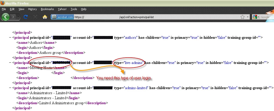

    yeah I did get what you mean in the image, when I get the principal-list I do have that type=live-admins also but no chance on creating the meeting..
    should I use the meeting hosts as my login??

    Hello
    please find attached image for detail idea of how to know your user type.
    review this and let me know your feedback.

    Feb 4, 2010 1:05 PM UTC
    Hi rye316,
         User must be an Administrator to create an meeting,
         Which means the user is a member of the Meeting Hosts group.
         In the response from principal-list, this group has type=live-admins.
