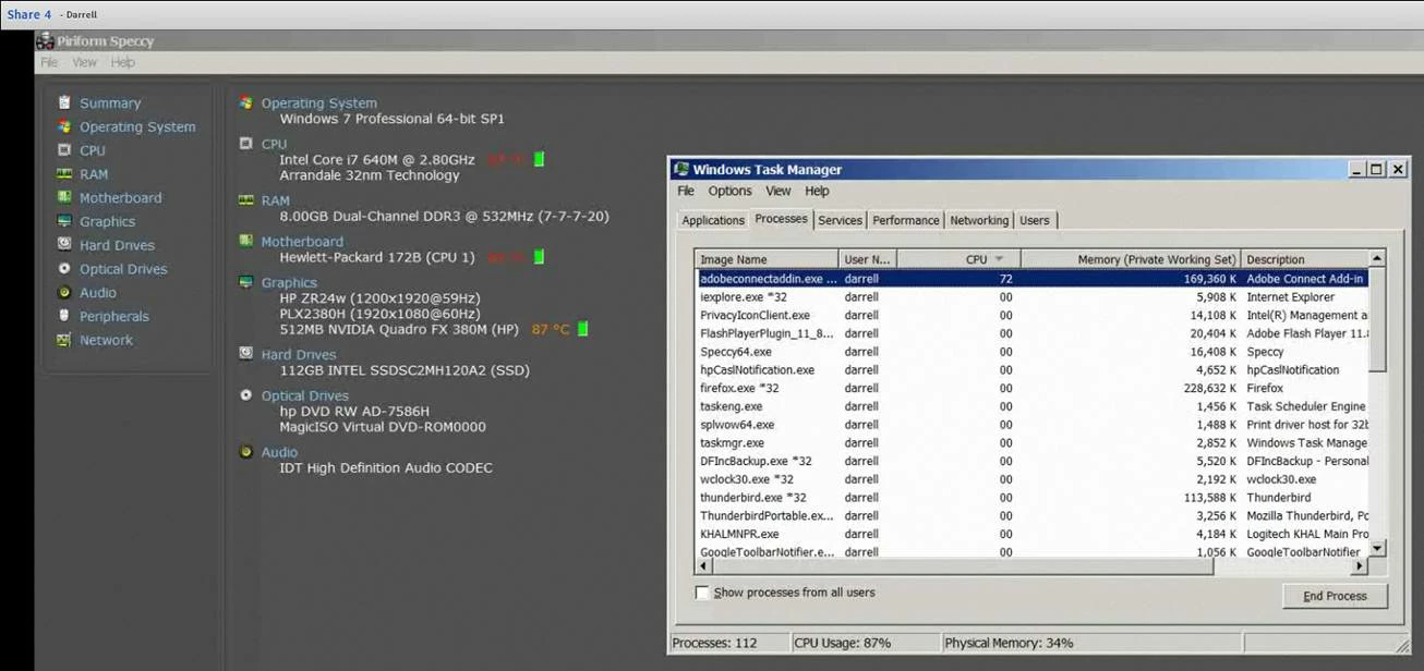

Adobe has sent me generic instructions on decreasing screen resolution, cleanup desktop, blah blah which is not helpful. My machine has been running fine with Acrobat Connect for four years and suddenly this problem appears. It does not happen on another machine with same screen res, network connection, etc. however it is running Win Server 2008 R2.
Here is my configuration and screen shot of task manager and resources monitor showing connect consuming bandwidth and being non-reponsive:

We experience the same thing as Lukasz reports.
We have seen CPU temp on machines climb from 55 degrees C to
100 degrees C within 5 minutes of loading AdobeConnectAddIn.EXE on several occassions, that is with or without screen sharing, with AdobeConnectAddIn.EXE clearly using between 50-80% of CPU from point of startup.
We have seen CPU demand for AdobeConnectAddIn.EXE jump to 80%,
as soon as sharing MS WORD, but can't say would not happen without screen
sharing because we have seen the high CPU usage happen without screen sharing.
In general AdobeConnectAddIn.EXE aggressively consumes most or all available CPU driving general CPU use to 100% (ceiling usage).   This only began with ver. 11.2.385.0,
Our team has been have using Adobe connect intensively for 3 years w/o this sort of problem until ver. 11.2.385.0, was forced in Adobe connect upgrade window in the last 7-10 days.

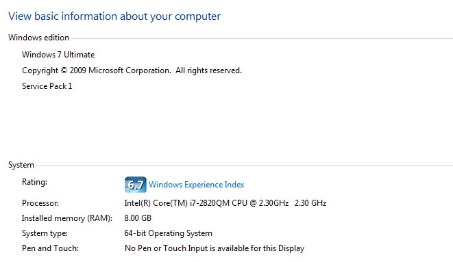

Per screen resolution - 1200X1920
CPU Usage - 50% to 80% + experienced when loading add-in.
CPU heat increases - 40degrees celsius within 5 - 8 minutes of loading add-in.
Other : We do not use video or audio features of Adobe Connect.
Our primary desktop sharing is limited to MS Office and text based information sharing.

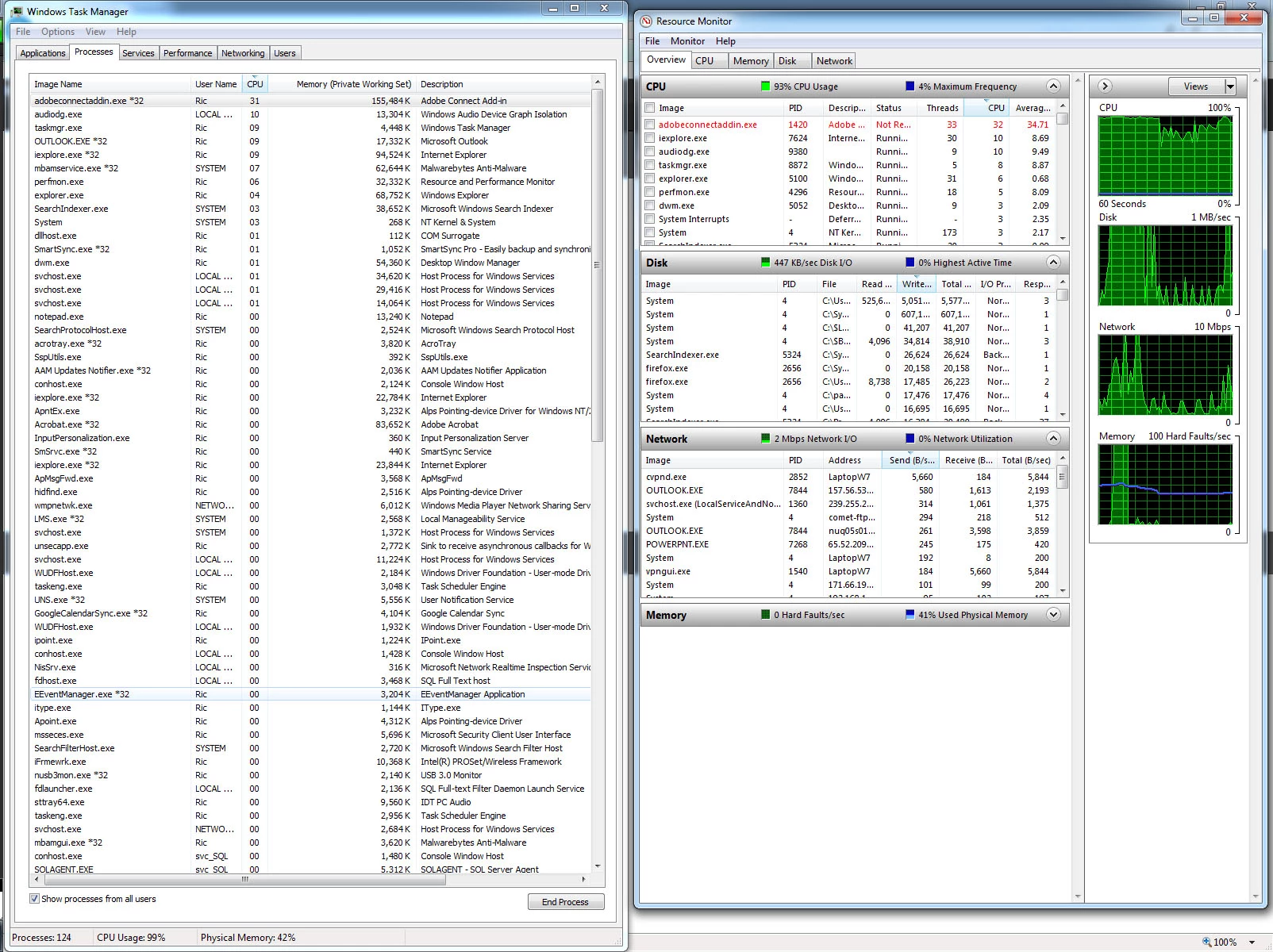

Several people on our team have been complaining about 11.2.385.0,
crashes and systems driven to 100% CPU usage.
Also we have seen machines heating up 10-20 degrees instantly when AdobeConnectAddIn.EXE is running, with temp running to 100 Celcius.
No other significant software is running on the machine, you will note
most other apps are on idle.
Soon after on this machine temps jumped to 100 and the machine shut down.
