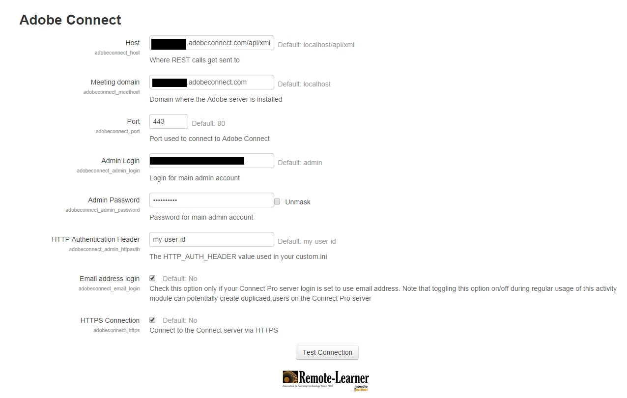

How do we determine the HTTP authentication header for our hosted solution?
How do we determine the HTTP authentication header (adobeconnect_admin_httpauth) from our hosted solution? The documentation says to find it in a custom.ini file but I have no clue how to access that.
I need to supply that to the adobeconnect plugin used with a Moodle instance, screnshot below.
If it helps, when I click "Test Connection", I see the following output.
A series of tests have been run in order to determine whether the Adobe Connect Pro server has been properly setup for this integration to work and to also determine whether the user credentials provided in the activity global settings has the correct permissions to perform the neccessary tasks required by the activity module. If any of the tests below have failed, this activity module will not function properly.
For further assistance and documentation in how to set up your Adobe Connect Pro server please consult the MoodleDocs help page for this activity module Help page
Sending common-info call:
successfully obtained the session key: na11breezrirhb4f4ryf5shqy
successfully logged in as admin user
Testing retrevial of shared content, recording and meeting folders:
error obtaining shared content folder
XML request:
<?xml version="1.0" encoding="UTF-8"?> <params><param name="action">sco-shortcuts</param></params>
XML response:
<?xml version="1.0" encoding="utf-8"?> <results><status code="no-access" subcode="no-login"/></results>
error obtaining forced-archives (meeting recordings) folder
XML request:
XML response:
error obtaining meetings folder
XML request:
XML response:
error creating meeting testmeetingtest folder
XML request:
<?xml version="1.0" encoding="UTF-8"?> <params><param name="action">sco-update</param><param name="type">meeting</param><param name="name">testmeetingtest</param><param name="folder-id"/><param name="date-begin">2015-03-14T06:53:39.000+00:00</param><param name="date-end">2015-03-14T07:53:39.000+00:00</param></params>
XML response:
<?xml version="1.0" encoding="utf-8"?> <results><status code="invalid"><invalid field="folder-id" type="id" subcode="format"/></status></results>
error creating user testusertest
XML request:
<?xml version="1.0" encoding="UTF-8"?> <params><param name="action">principal-update</param><param name="first-name">testusertest</param><param name="last-name">testusertest</param><param name="login">testusertest@test.com</param><param name="password">9B396EA828A00203FB3E8E69010FE537</param><param name="extlogin">testusertest@test.com</param><param name="type">user</param><param name="send-email">false</param><param name="has-children">0</param><param name="email">testusertest@test.com</param></params>
XML response:
What are we missing?
Thanks!

Here is the docuementation for loging in with an HTTP Headder Adobe Connect 9 * Log in from an application
Seeing as there may be some modification to files on the server, you may need to work with Adobe Support to see if they can be modified in the Hosted environment.Adobe Connect Help | Adobe Connect Support
