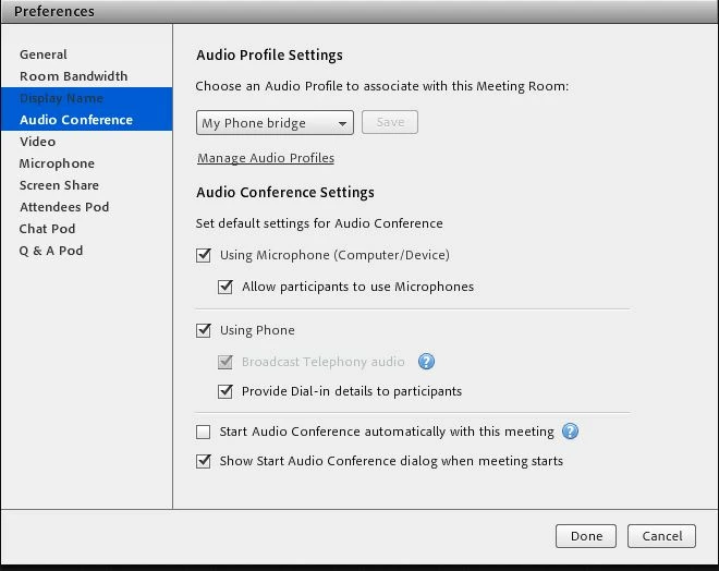

Not sure where the setting was in Connect 8 (other than the Auto-Promote Participants to Presenters). With Connect 9, you now have the Audio Conference Preferences dialog (Meeting > Preferences > Audio Conference). With my M1 bridge attached to the room (full integration), I'm not able to do both VoIP and phone at the same time. I don't believe I ever was able to do this. Here is what I see (radio buttons for VoIP or Phone):

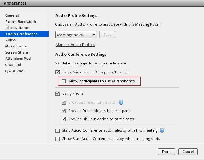

However with a Universal Voice (UV) profile, I am able to pre-define that participants get mic rights. Here is what I see with the UV bridge associated with the room (check boxes for both VoIP and Phone):
With the UV bridge (or straight VoIP I suppose), I can predefine that all participants get access to the microphone when I activate the audio bridge (or if I set it to start automatically, when I activate the room as the host).

Hi Abhinav,
The setting is not persistent in any of our rooms.  After entering a room with a universal voice audio profile with MeetingOne, I click on Audio > Audio Conference Settings.  The 'Allow participants to use microphones' option is disabled.  After enabling this and clicking done, the setting is only saved for that meeting.  When I re-enter the room after ending the meeting (and waiting 15 minutes), the setting is reverted back to being unticked as per the screenshot below.  I would like to enable this by default for every meeting rather than have it disabled by default.
