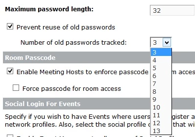

Apr 30, 2014 10:47 PM UTC
Well it looks like I may have to take back my statement on using old passwords. There is now (Connect 9.2) the ability to limit the ability to not reuse a password up to 13 prevous passwords. This option is under Administration > Users and Groups > Edit Login and Password Policies.
