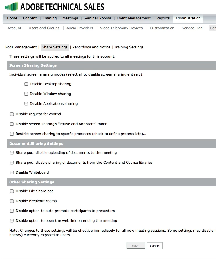

    I'm not sure what you mean by forwarded...did you send it to me via email? You could have posted the picture in the fourm using the camera icon...seems easier that way.
    Have you talked to the system adminsitrator?
    Here under the Administration tab there is a tab for system restrictions (compliancy):
    Notice the DISABLE BREAKOUT ROOMS.  I bet your administrator has checked the option. That explains the reason.
