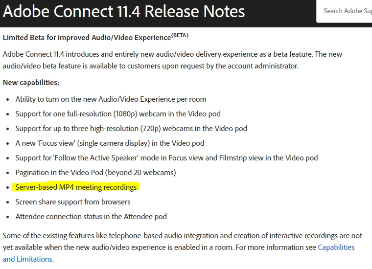

    Ah, looks like I was behind the technology curve here. This appears to be change in Adobe Connect version 11.4 (I was using version 11.3c).
    I expect that this is because there is going to be a shift in how recordings are made on the server side of Connect. They are going to be created as MP4s soon, as seen in the notes of the beta features in 11.4.
