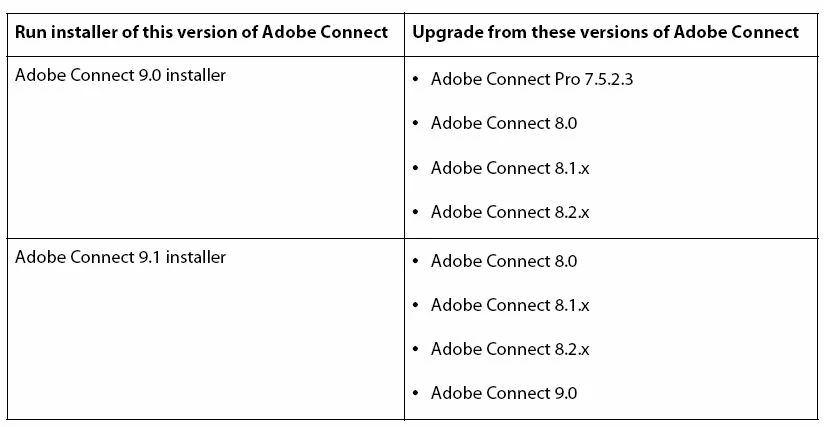

    From what I can see in the documents I have (not just the ones listed here Adobe Connect Learn & Support), you can probably go from Connect 7.1.2 to 7.5.2.3 (not sure that this is a one step process, I don't have documentation for upgrading to Connect 7.5) to 9.0.x to 9.2 or 9.3 (which ever version you ultimately choose). Here is the list of possible upgrade paths from the Connect 9.1 install documentation:

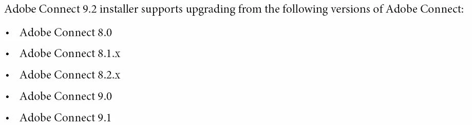

    And from the Connect 9.2 install documentation:
    For what it's worth, Connect 9.3 requires a Connect 9.X installation for upgrading, Also, Connect 8.1 shows only being able to upgrade from Connect 7.5.x, so you may be able to skip Connect 8 all together.
