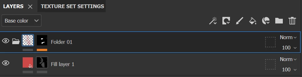

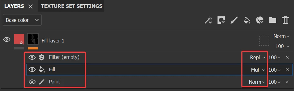

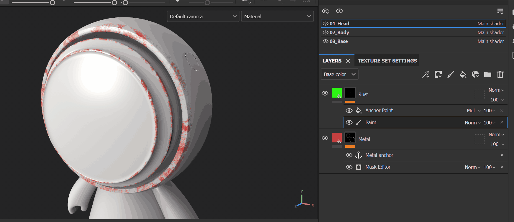

Usually, when you need to paint on a very specific part of the model, you'll need to add a paint layer to your mask. Therefore, you can add a mask to your rust layer, add a paint layer and a fill layer with the anchor point set to multiply. But a picture is worth a thousand words

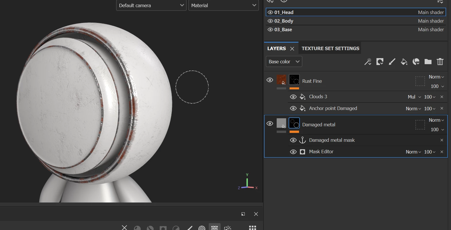

You can't add a mask within a mask, this isn't really the current type of workflow with Substance 3D Painter (with that being said, the folders can have a mask and contain masked layers).
Within a mask, instead of another mask, it is possible to add several layers. Usually it's these layers and their Blending Modes that will build a complex material.
To take the example of the rusty steel chair, that will need two separated layers, because those are two different type of materials (unpainted steel and rust). Basically, you'll need the rust to use the mask of the damaged steel and for this, the Anchor Point is the perfect tool.
To make it simple, the Anchor Point exposes the resources where you placed it and you can use these exposed informations later on in another layer.
Tell me if you need anymore guidance.

okay this much i was able to get working. using anchor points i was able to contain the rust inside the damaged paint mask that exposed the bare steel layer below.
