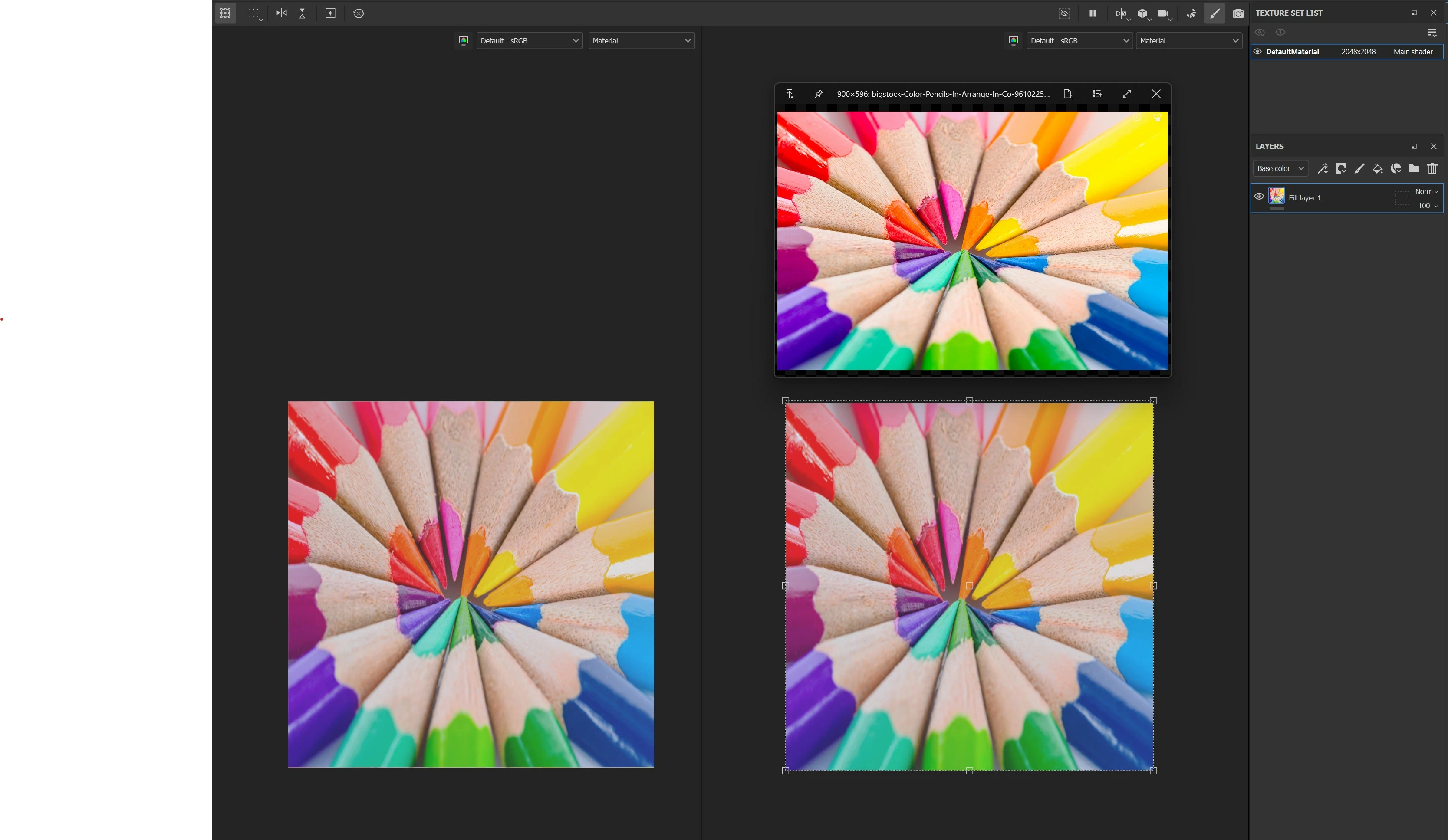

I'm facing the same issue, and that's exactly when you want to import some texture from the web, and colors must be the same. But it seems color conversions are not good enough to preserve them. The Aces_cg color space always toned down the highlights, and the images look dull. Take a look at this simple test. On top right we have the original image taken from the web.
The responsible for this color conversion is icio.config file, which, by the way, each software has its own built-in and they are not respecting a standard. That's the impression I have.

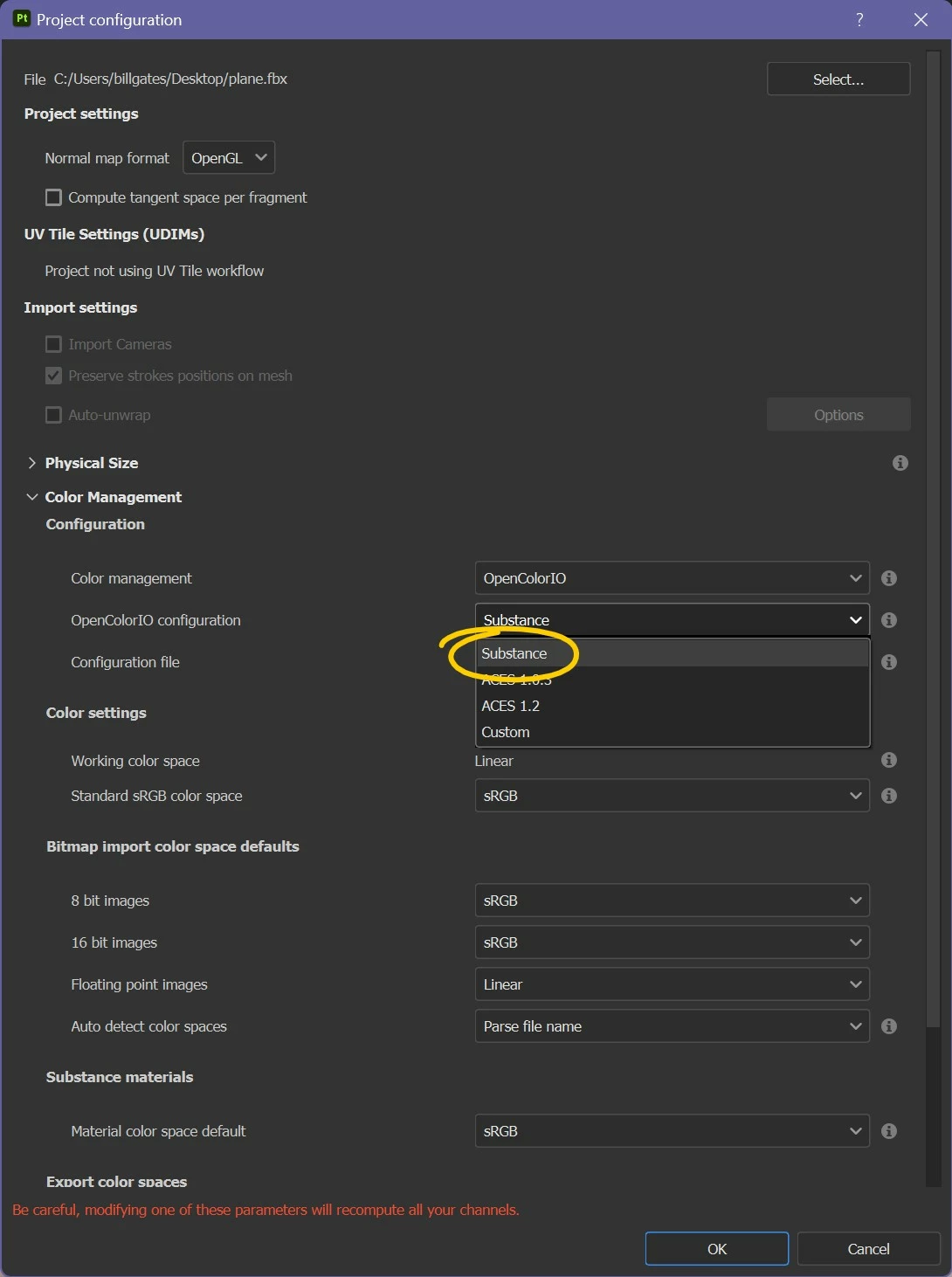

Substance Painter has it and it seems to do better color conversion than Aces 1.2. I believe the key here is to load the same config file in all software.
Please correct me if I'm wrong and I would also like to know if you found a solution for this.

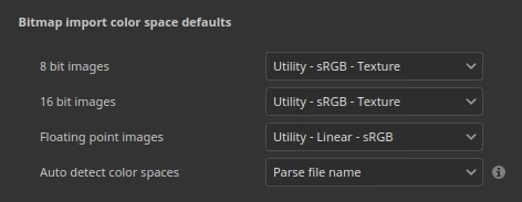

If you use our default ACES configurations, 8bit images (aka non-hdr resources) should default to sRGB too. You likely want to keep that setting this way most of the time. Example:

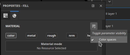

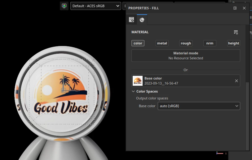

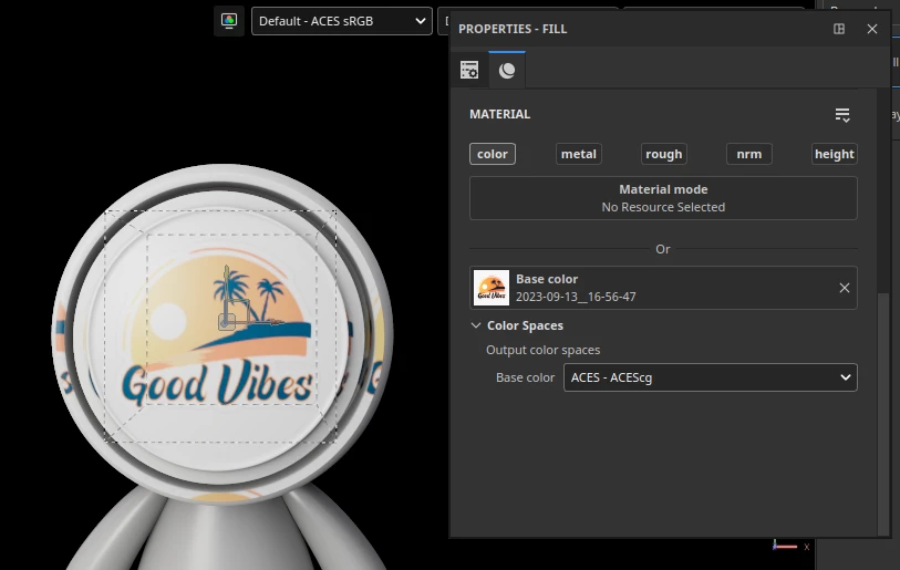

Now if for some reason you want to import SDR images as ACEScg by default, you can still override the color space of a specific resource from within the layer stack. You need to enable the color space menu first, like so:
Here is an example comparing between the two color spaces:
