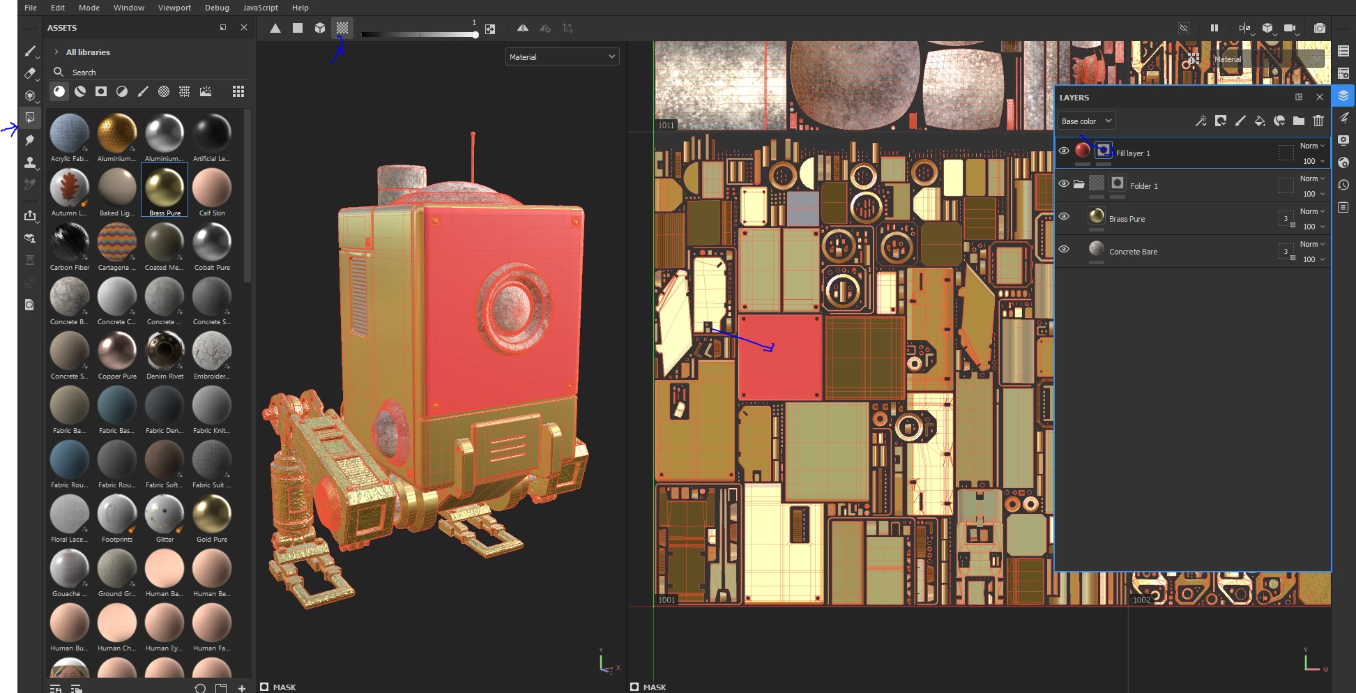

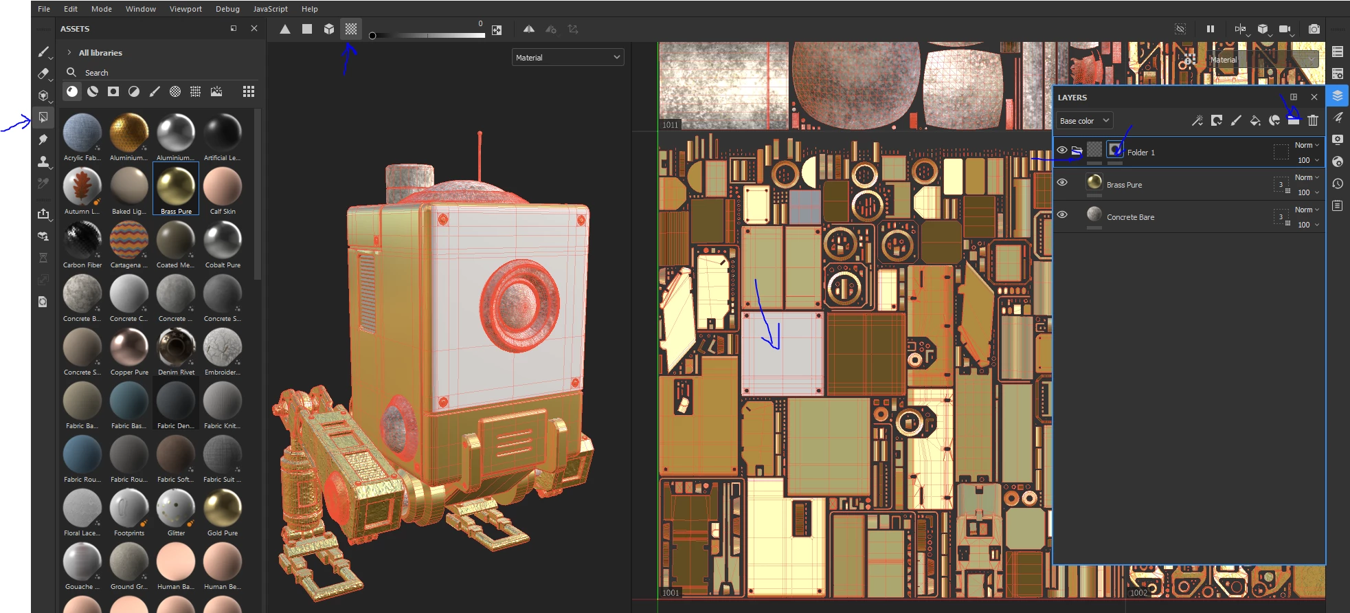

One possibility once you have added the new piece of geometry isl: you create a group and put all your layers, then create a white mask and then use the polygon fill to exclude the new UV chuncks/Islands:
and then add a layer, create a black mask and select the chunk with polygon fill:
