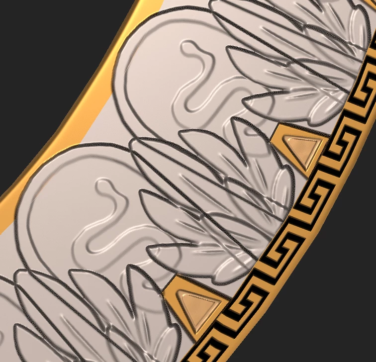

Hello, does anyone know how to not make alphas overlap one another in substance ? I tried erasing the parts that are on top of another but it don’t work that well. They’re both in separate layers too.

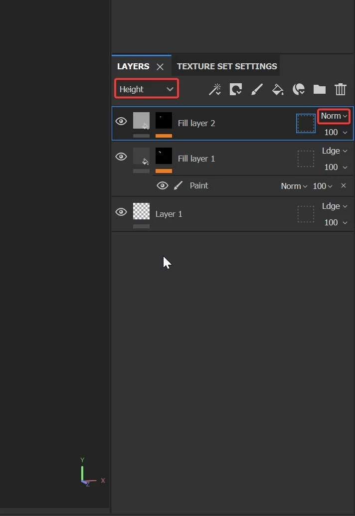

Hi Henry,
You'll have to set up a different Blending mode for the alphas. Try to switch the blending mode from the top alpha to Normal. Make sure you're in Height Mode.
Best regards,
Cyril Dellenbach (Micro) | Product Manager | Substance Painter
