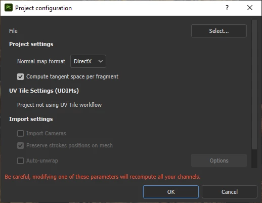

Hi
You need to modify the mesh outside Painter and then in Project Configuration you reload the new mesh by selecting the mesh and clicking ok:
