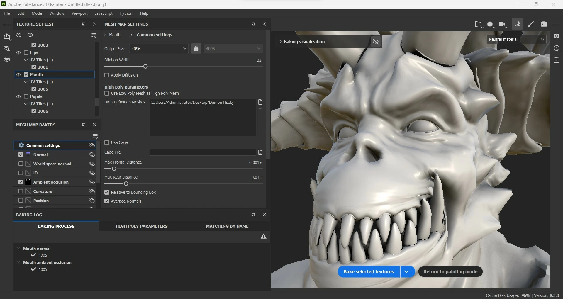

hey,

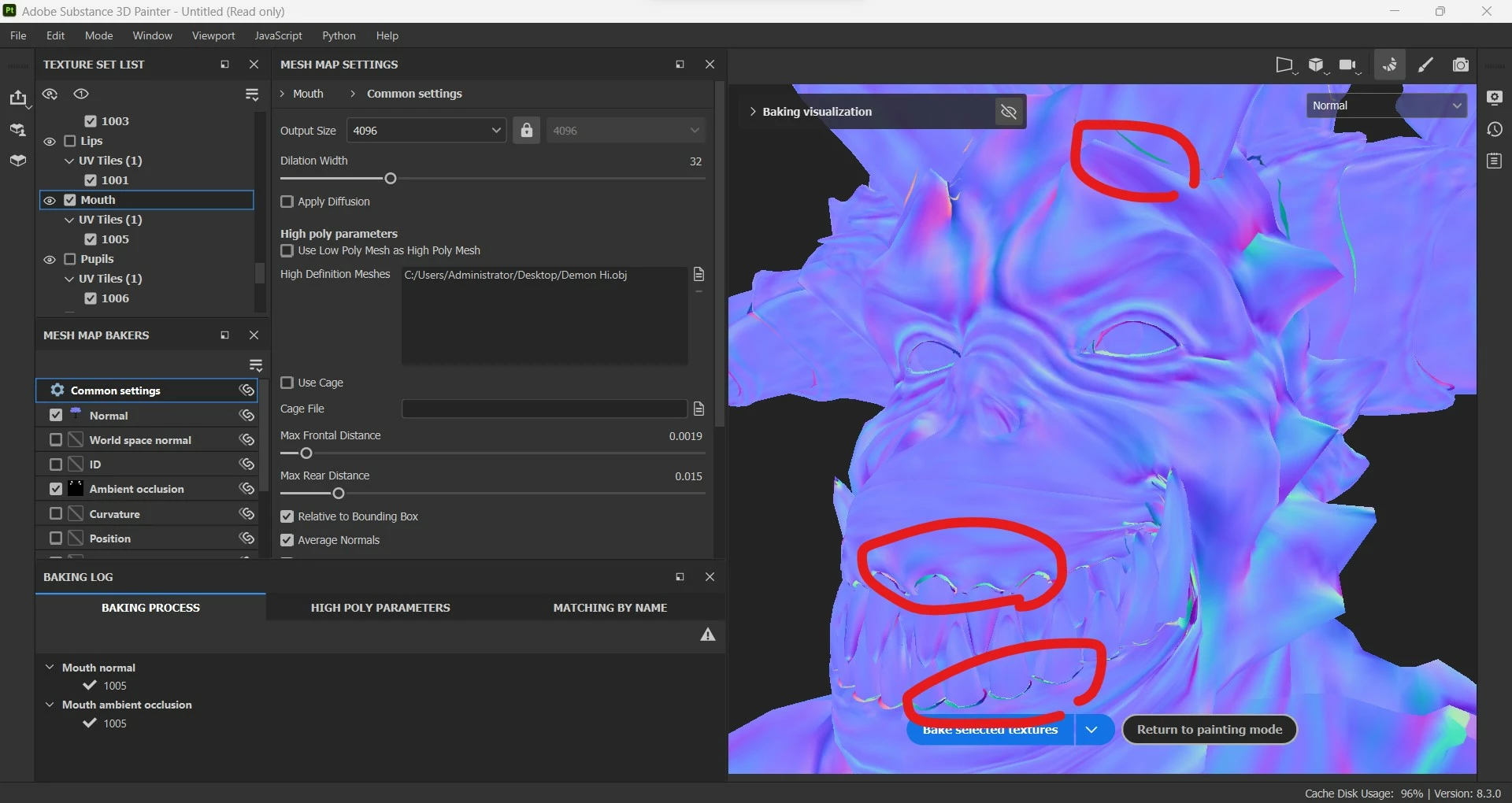

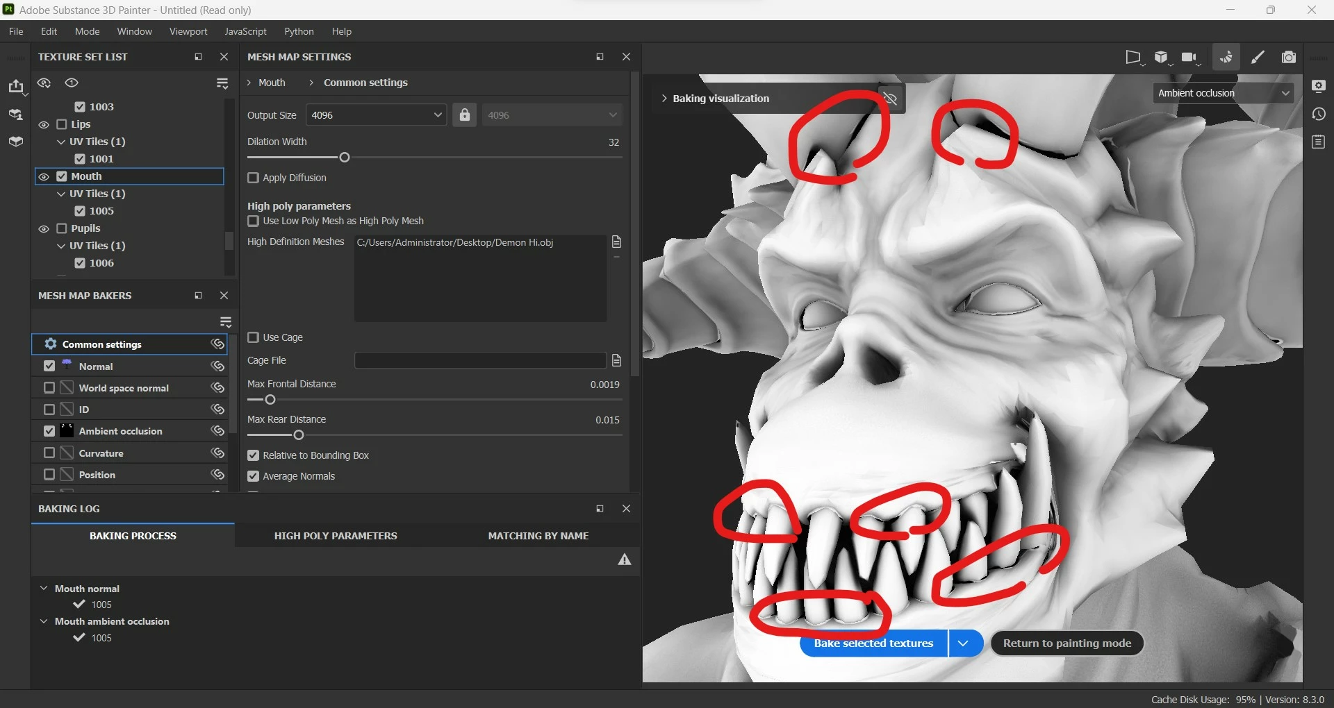

how can i clean these messed up on baking?  :]
i tried to change Max Frontal Distance by case, but can't get good results ...

Hello @DavoodKharmanzar,
Thanks for the message.
The artifacts you highlighted are due to closed objects. In the baking visualization parameters, if the cage surface opacity is enabled, you should see where the cage intersects and you should be able to adapt the Max Frontal Distance precisely.
With that being said, it seems it's already what you did, so if the cage issue persists whatever the parameters are, I'd advise you to make a baking matching by mesh name. Depending on your project, this can be a bit tedious to set up, but the results are always clean.
Have a nice day.
