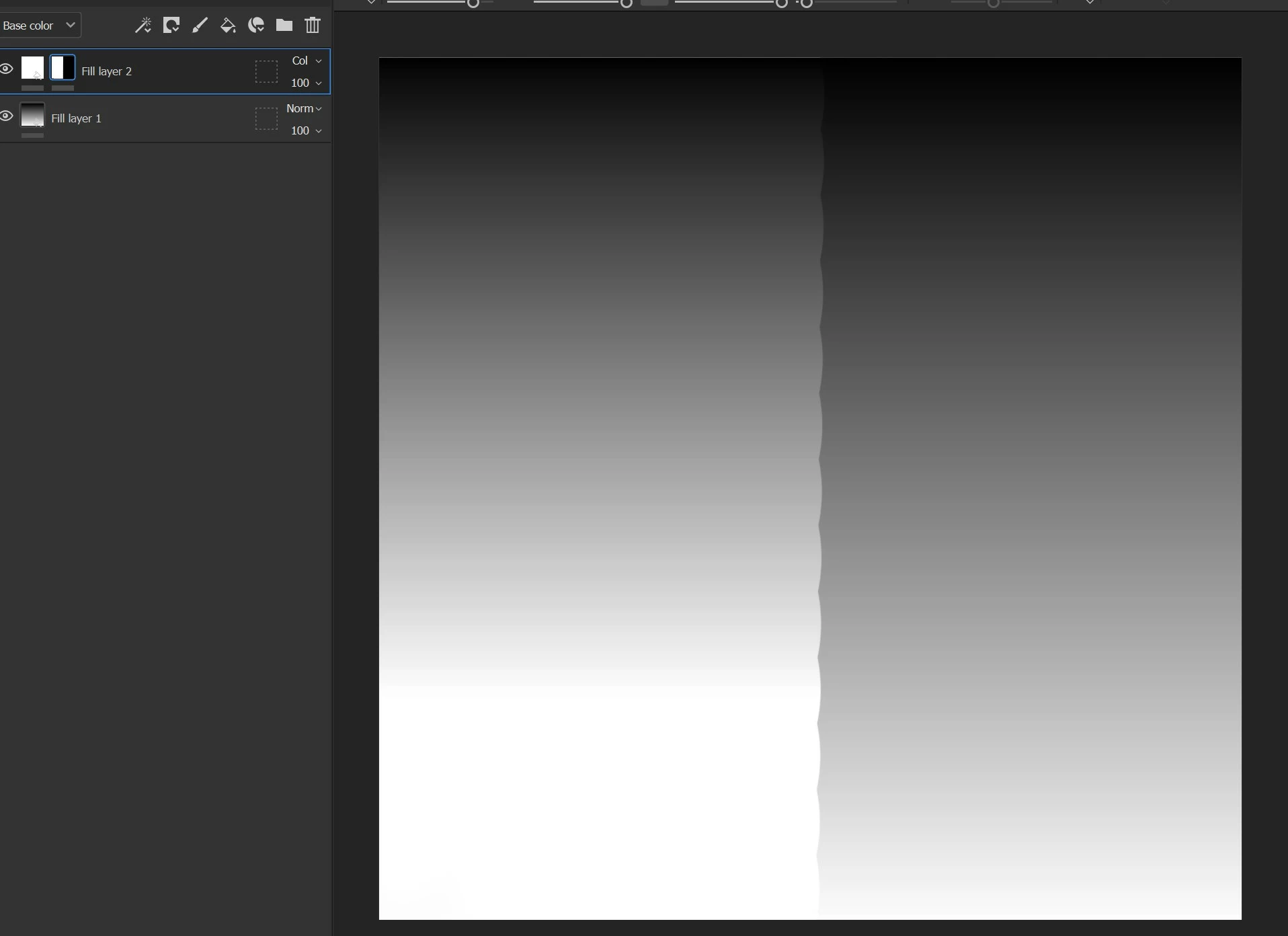

Ok, either i dont get soemthing or the color mixing mode for any layer is comepletly broken.
Every time i set a layer form "normal" to "color" it just burns out the texture and bumps up the brightness by 90% and turns almost every layer white.
And its not like it started now, it always was broken, no matter the version it never worked, so far i just never used it.
But i gotta ask, is there a way to actually make it work?

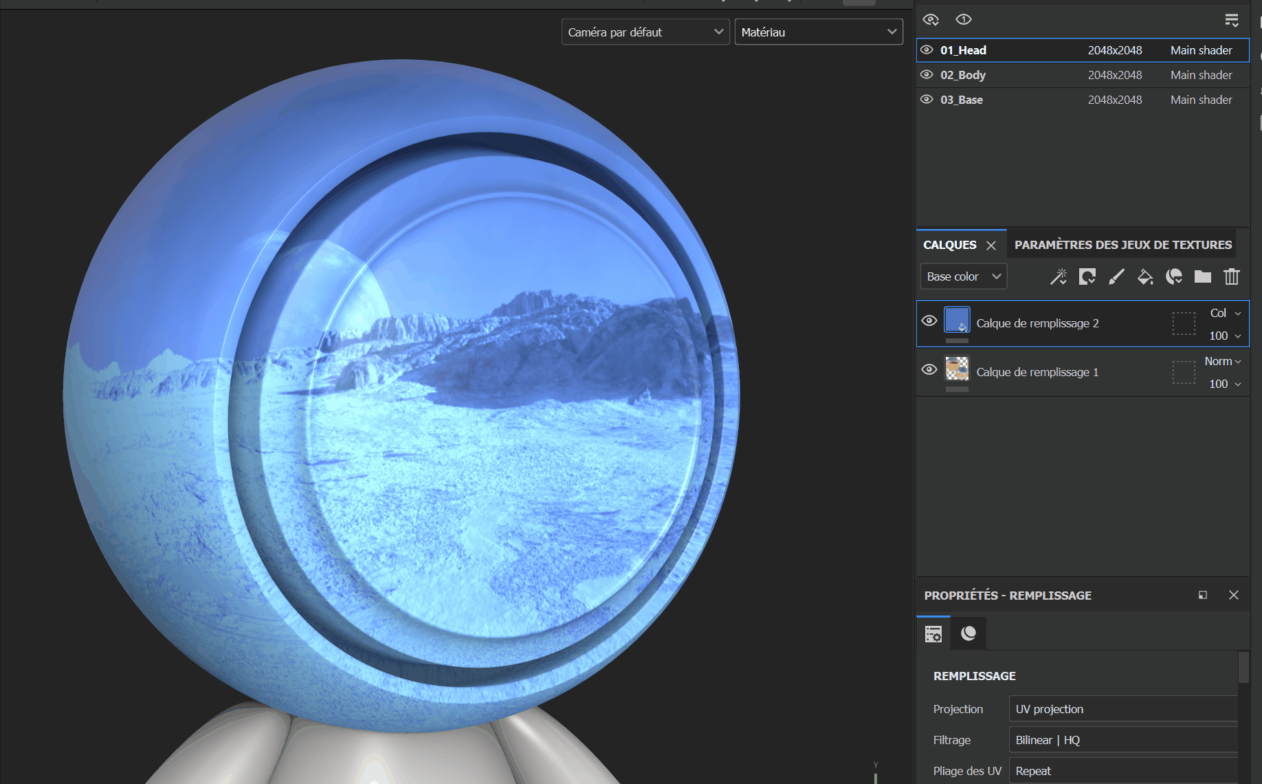

As you mentioned in your message, Substance Painter has always blended color this way, because it isn't a bug, but a different color conversion than what other software on the market do (in particular Photoshop, which people are really used to).
The color blending mode isn't broken and works as it should,
but in specific scenarios such as your example, the way Painter makes the conversion will become an obvious downside.

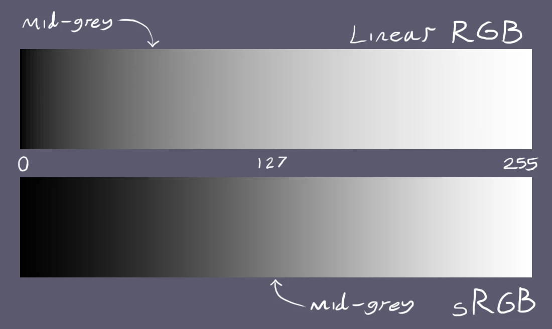

To make it simple, you should expect these blending modes to act (mostly) as any other software, but our blending is done in another color space, creating slightly different values.
When you're watching your textures on the 3D model, those are (natively) shown in a SRGB color space. But when you're blending layers together, the SRGB maps will be converted into a Linear RGB color space (for accuracy), before converting the result once again in SRGB.
With the blending modes Value, Tint, Saturation and Color, there is another color space conversion (HSV), and all these changes can result with slightly different values, which can become very obvious in specific scenarios.

Jul 25, 2023 6:15 PM UTC
Every version.
Its broken, it was always broken, at lest since i started using substance 4 years ago.
I mean even a simple test, add a white layer in color mode over any texture, it will completly destroy the values, its not even subtle, makes using it for painting stuff up inpossible as you can see my every brush stroke.
Again, maybe i dont get something? Some button somwhere?
davescm
Jul 25, 2023 9:33 PM UTC
Thanks for the test - I can replicate that and it does indeed appear broken.
I also tried duplicating the grey gradient layer and turning on and off visibility of the duplicate, changing the blend mode. With that test Col, Val, Saturation and Tint all appear to give unexpected results. With identical layers Col,Val, Hue and Tint blends should show no difference.
@Cyril Dellenbach are you able to replicate this and, if so,  report internally?
