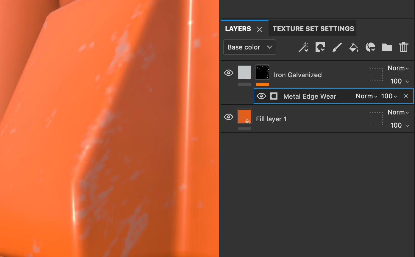

"Generator Filter - Metal Edge Wear" Doesn't work correctly
I'm new to Substance Painter and I'm watching this tutorial right now.
At minute 2, a "generator filter" is added to the mask and then a "metal edge wear" is added to the generator.
For me, the edges are not masked, but scratches appear on the object.
Am I doing something wrong?

Hi @Mahmud3107343935mp,
I'm glad you found a solution.
To use these types of filters/generators, you indeed need to have your mesh maps baked. The Curvature can be baked from the Mesh or from the Normal map baked earlier. Those are two different techniques (from Mesh is more recent), but both should work as expected.
If the Curvature baked from Mesh didn't work for you, there were probably some parameters to adjust, but using the Deprecated method was also a solution.

hi, so i fixed the issue. you have to change the Msh map settings for curvature to "Generate From Normal Map (Depreciated)" and rebake your map

Jul 14, 2023 4:39 AM UTC
