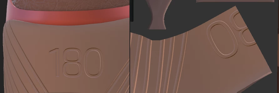

How to mirror a layer after it's painted
I was wondering, is it possible to mirror a layer after it's been painted? I have accidentally painted several layers on one side of my model without mirroring turned on, and now wish to flip those strokes over to the other side also. Is there any way to do this? I've tried adding a Mirror Filter to each layer, but it doesn't work and acts strangely, almost as if it's expecting my UVs to be perfectly symmetrical as well, which they're not, as the model was packed arbitrarily; i.e the UVs are the same on both sides, but not laid out symmetrically.
Appreciate any thoughts on this.
Seán
