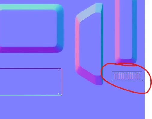

Thanks for the reply. Where do I find the color tolerance parameter? I don't see it under the ID section of the Baking settings window.
In my specific case, I added the circled element to my trim sheet, and since I already had an ID map wherein each element was assigned a unique color based on Mesh ID, it would have been nice to preserve the colors for everything that already had colors assigned while assigning a new color to the circled element.

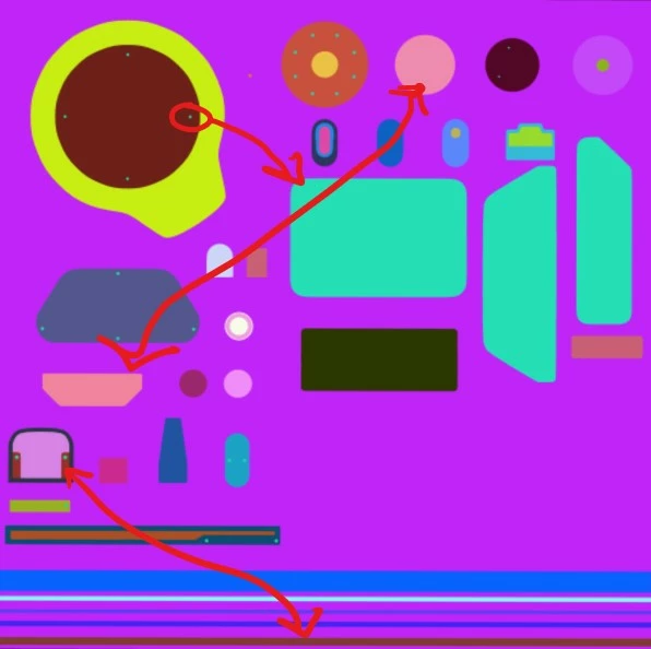

Also is there a way to prevent Substance from choosing the same color for separate mesh IDs? That kinda defeats the whole purpose of ID maps
evany90292982
Dec 10, 2023 1:59 AM UTC
In my export, these meshes are separate, but lo and behold, they share the same freaking color!!!!!!
