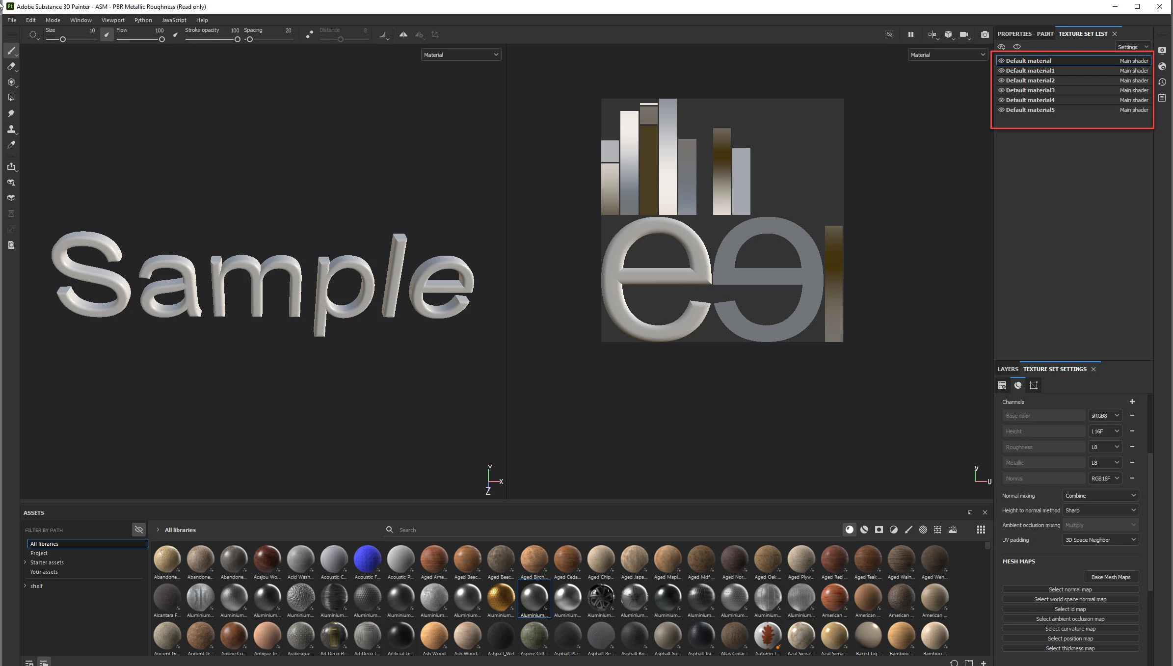

In stager I select and export the object, as GLFT, and open it, in a new set in Painter.

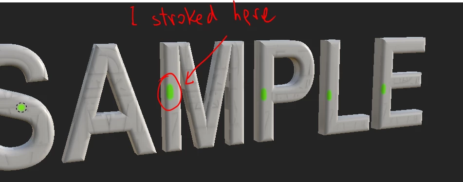

Before & After I bake the texture, when i try to paint on the 3D, instead of painting of a single letter to paint 'spiils' on all layers.

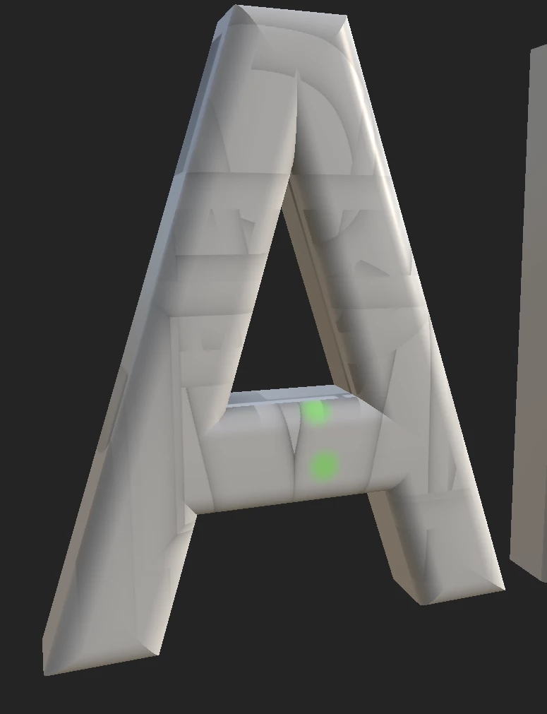

After baking there are strange patters on the object:

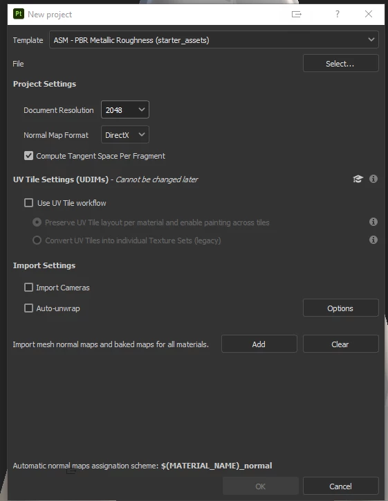

These are the basic import settings I use:

The problem is that your letter surfaces are sharing the same UV space with the parts of the unwrapped surfaces overlapping rather than being laid out as separate islands on the UV map.

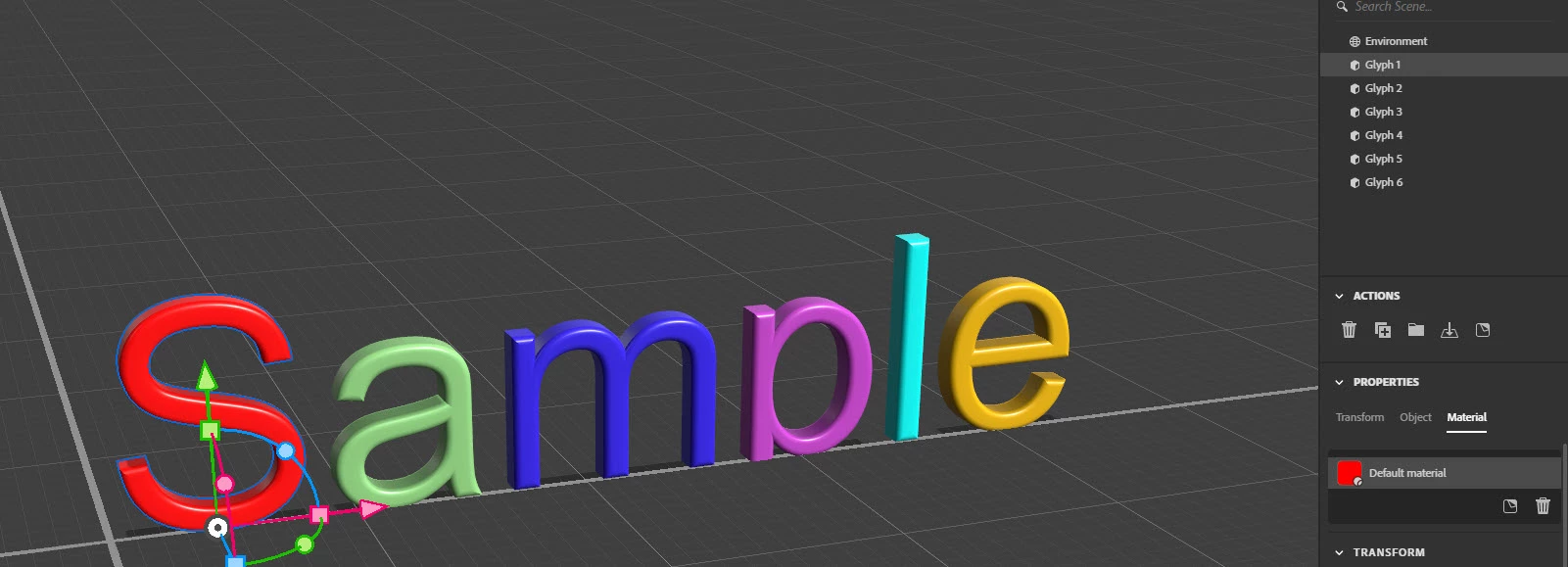

2. In 3D Stager convert the letters to standard models and separate them. to do that:
a. Select the text object and use Object >  Convert to standard model
b. Click away from the letters then click on them to reselect them and use Object > Ungroup. This will give you separate models named Glyph 1 , Glyph 2 ...etc
c. Put a separate material on each glyph object (i.e. each letter) by going to the material properties for each glyph object,  clicking the link symbol under the material which will change it to Default, then giving that letter a basecolor Hue that is different for each letter. See below:
d. Select all the letters (or just some if you want to export some separately and export to GLTF
e. In painter you should see a separate material for each letter with no overlaps on the UVs
You can now carry on and bake as normal
