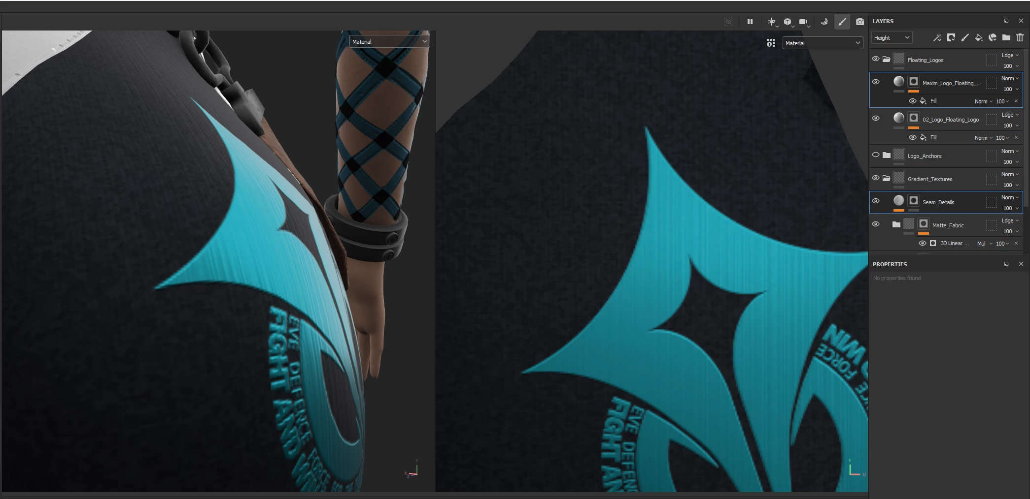

I have an issue similar to the one here : https://community.adobe.com/t5/substance-3d-painter-discussions/how-to-remove-a-lower-layers-height-from-an-upper-layers-decal/m-p/14036954
But the solution is not working in my case.
I am trying to keep the scratches on the rest of the texture and remove it only on the blue logo.
The scratches on the logo and the rest come from the Seam_Details Fill layer below.
For the logo I anchored the image in a Fill layer that I reference above in the Floating_Logos folder. That way I can move the logo anywhere. However, now this specific logo inherit the scratches from below and no matter what blend mode I try I cannot get rid of the scratches on the logo only.
If anyone could point me in the right direction it'd mean so much.
Thanks
Cyril Dellenbach

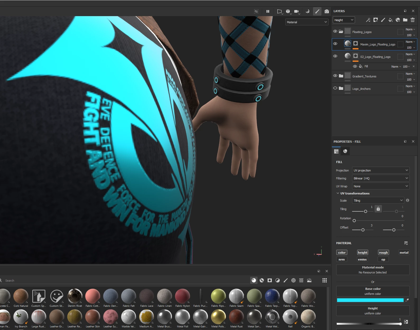

Hello @DeeRacine,
The blending mode from the group containing the logo also has to be set to "Normal".
Cyril Dellenbach (Micro) | Product Manager | Substance Painter
DeeRacineAuthor
Mar 11, 2024 1:31 PM UTC
Hi Cyril,
Thank you for the quick reply! It partially worked, as it did remove the scratches. However, The logo is now flat with the hieght set to 1 and anything below that makes it caved in rather than bumped out. Any idea why that is and how to solve it?
Thank you again
