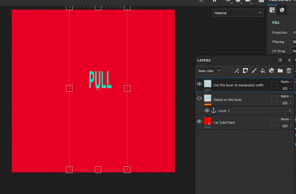

I am working on a project that requires me to stamp the attached alpha to my model. However, the alpha is wider than my model, so I was wondering if there is a way to only scale the alpha in just 1 particular axis (X Axis only). Thank you.

I don't know a direct way - but you could stamp on a layer then add an anchor. Reference that anchor from a fill layer (above it in the layer stack) which will give you the manipulator/transform controls
