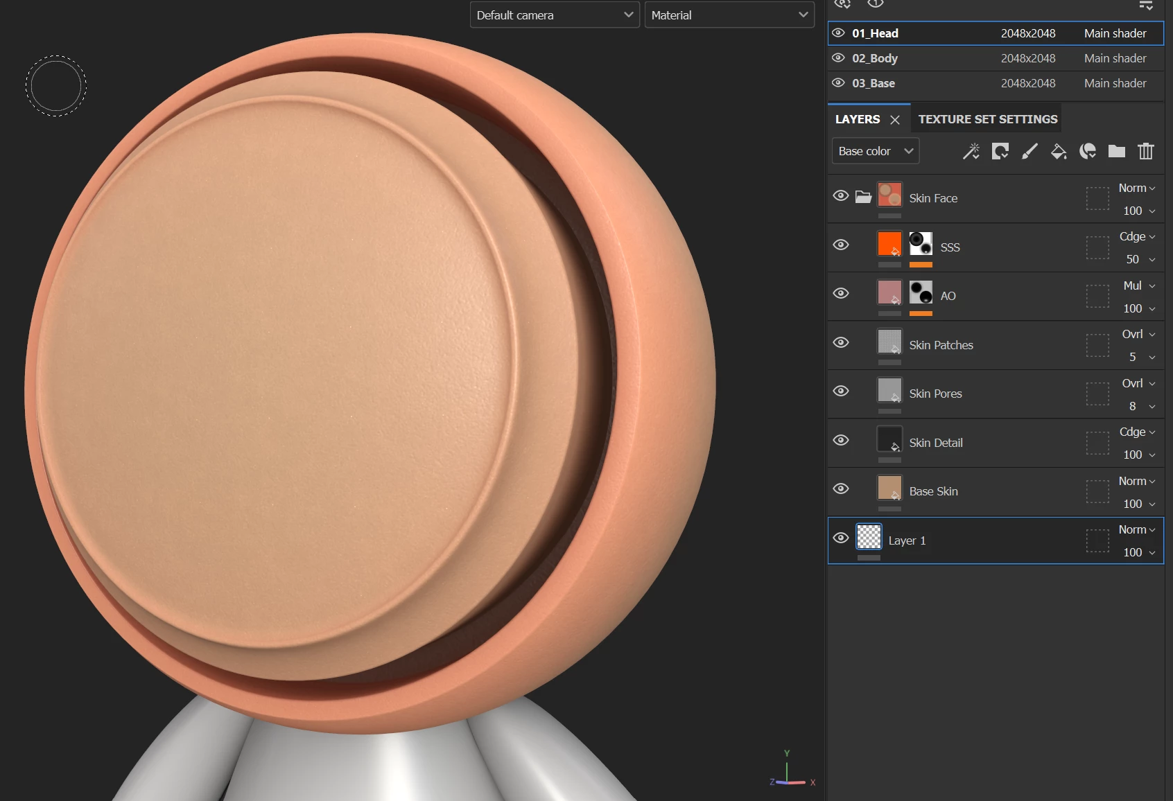

I have combined two different Layers with a Noise Shader and a Black Mask.
I want to combine some Noise with the Standard Layers. I cannot figure it out how to set the Colors (Layers) of the Shader.
The Tutorials with the two different Redshaders are useless to me. I dont want to draw at the Both Layers and just planed to do the Work with the Noise Shader, but they arent fine enough.
If someone would give me a Hint how i can combine two Skin Shader into a Complete Shade i would be gratefull. Maybe you can give me a step by step.

Hello @Conna3005,
Thanks for the message.
Would you mind sharing some screenshot and maybe the link to the tutorial so we can have a better visual on what you're trying to achieve?
With that being said, to create a complicated material from multiple layers, I'd advise you to take example on the Smart Materials from the assets library. As you can see, they are made from several Fill Layers with masks. This is a pretty common workflow.
Tell me if you need any more guidance and don't hesitate to send me visuals.
