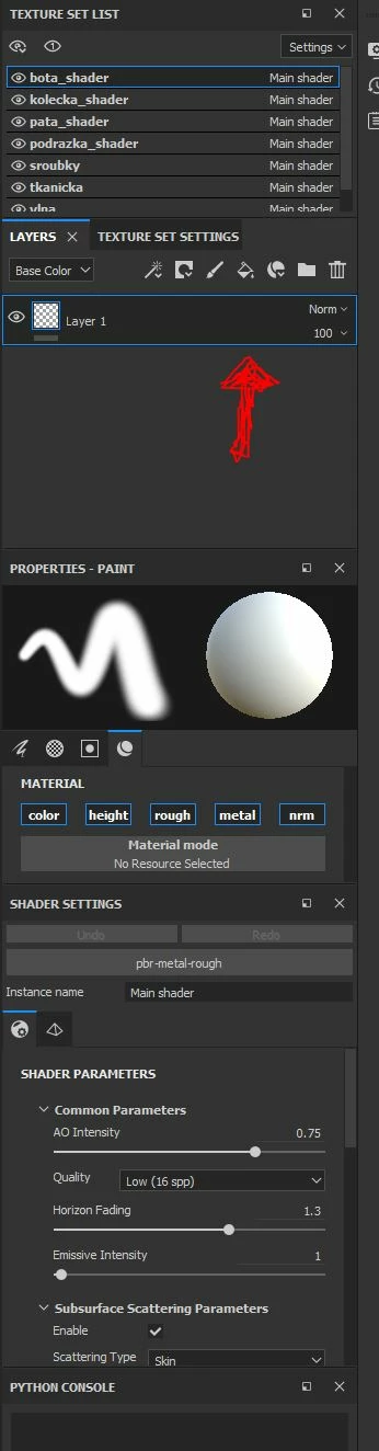

I don't see the geometry mash objects and properties
Please, give me an advice. I can't see objects from maya. I can't mask with objects or IDs. Where is the error? I export as fbx. I tried uv in maye both on 1 udim and on multiple UDIMs. In neither case do I see objects in substance with names from mayya, only in the 3D view. Please help!

What you are showing with the red arrow is the layer stack of your currently selected material, visible in the texture et list above.
For your ID map have you tried baking down those from a high poly?
I'm not sure if I understand what your issue is, please feel free to describe what you are expecting coming from maya?
