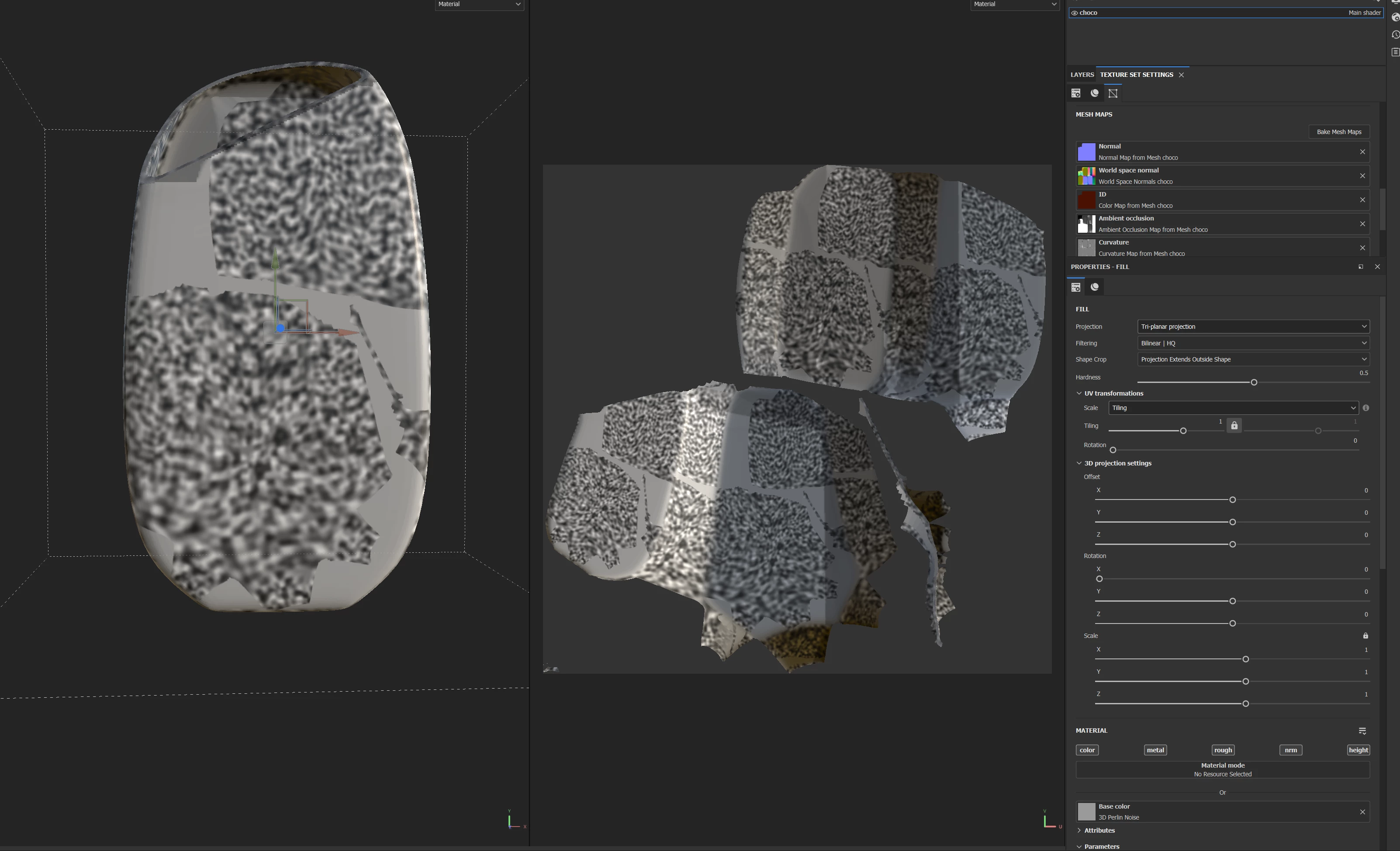

Mar 28, 2023 9:59 AM UTC
That's okay, no need of the .spp, the issue comes from the noise. The 3D Perlin Noise shouldn't be used with the Tri-planar projection, because it already uses the Position map to apply it in 3D.
You should either use the basic Perlin Noise with Tri-planar Projection or the 3D Perlin noise with a simple UV Projection.

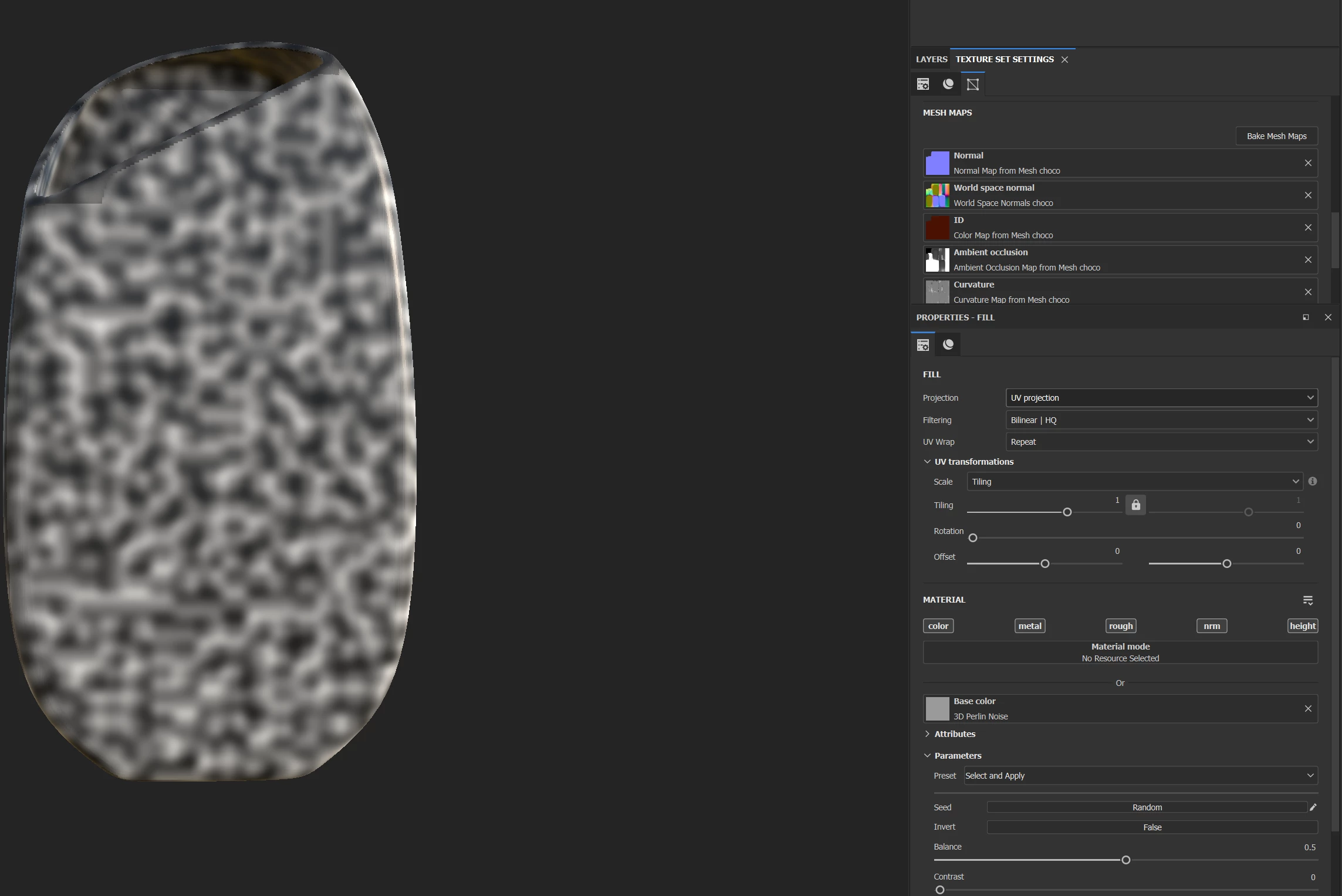

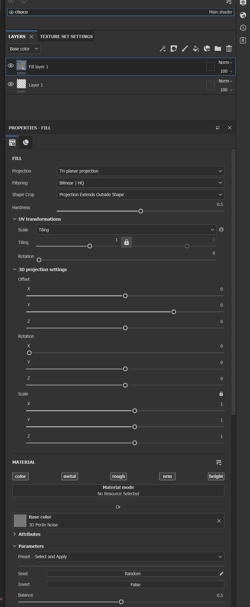

Mar 28, 2023 9:37 AM UTC
Hello @grafimedia-amsterdam,
This is definitely unusual. Could you share a little bit more infos? Can I see your layer stack, or could you even share the Substance Project, so I may investigate on my side?
Best regards,
Cyril Dellenbach (Micro) | Product Manager | Substance Painter
Mar 28, 2023 9:44 AM UTC
Mar 28, 2023 9:47 AM UTC
How Can I sent the .spp ? file is not allowed to send via this site?
