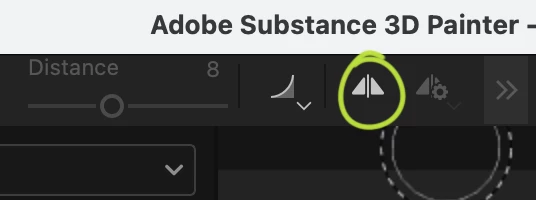

Hello, I know this is old and you probably figured it out, a very similar thing happened to me just now and in my case it was that for some reason (maybe I accidentally pressed a hotkey) to turn on the symmetry feature, you need to turn that one off.

I think the problem was that it had a symmetry painting tool activated
(don’t remember how I turned it off) but it should be a quick google search
👌 hope this helps!

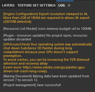

The log: (I don't know whether this is the log you were looking for, but this is all I found and this is all it displayed).
